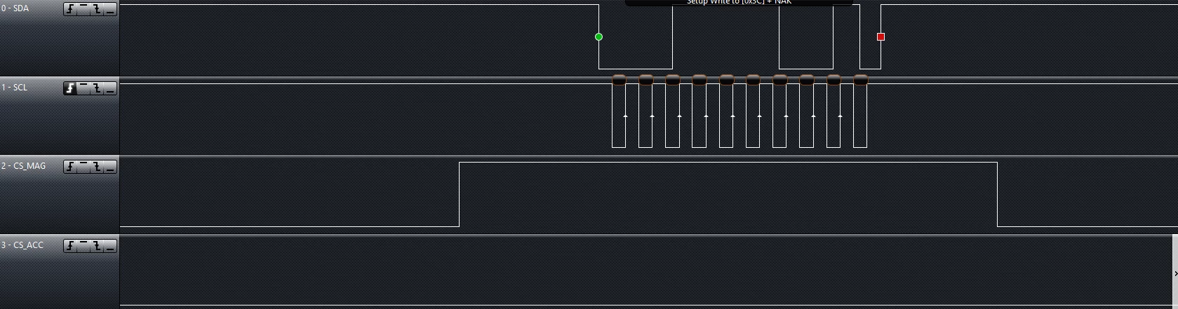

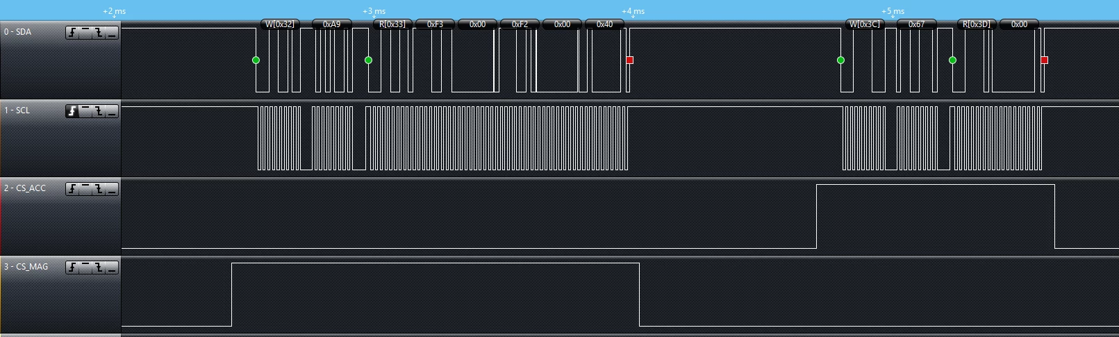

Once I remove two lines relating to accelerometer thresholds, then disconnect power for a while (must to be), it works again! I have checked all things on Logic Analyzer - I2C from STM32L011 works well too. With two thresholds lines there is no response from magnetometer (no ack to address).
It is a proper communication(without threshold lines)(CS_MAG should be CS_ACC):
This is ACK error when thresholds were stored (accelerometer works well):
I already tried:
  • change I2C timming/resistors etc.
  • software restart of all LSM303 registers
  • changed order of the readings
  • changed continous to single shot mode
What is wrong - I did not found any errata to this IC? I spent 3 days to solve it...
I also noticed that even when "threshold lines" are off, the data are ok for same time, but later there is no response from accelerometer or magnetometer. It looks like some problems with switching between those two sensors.
