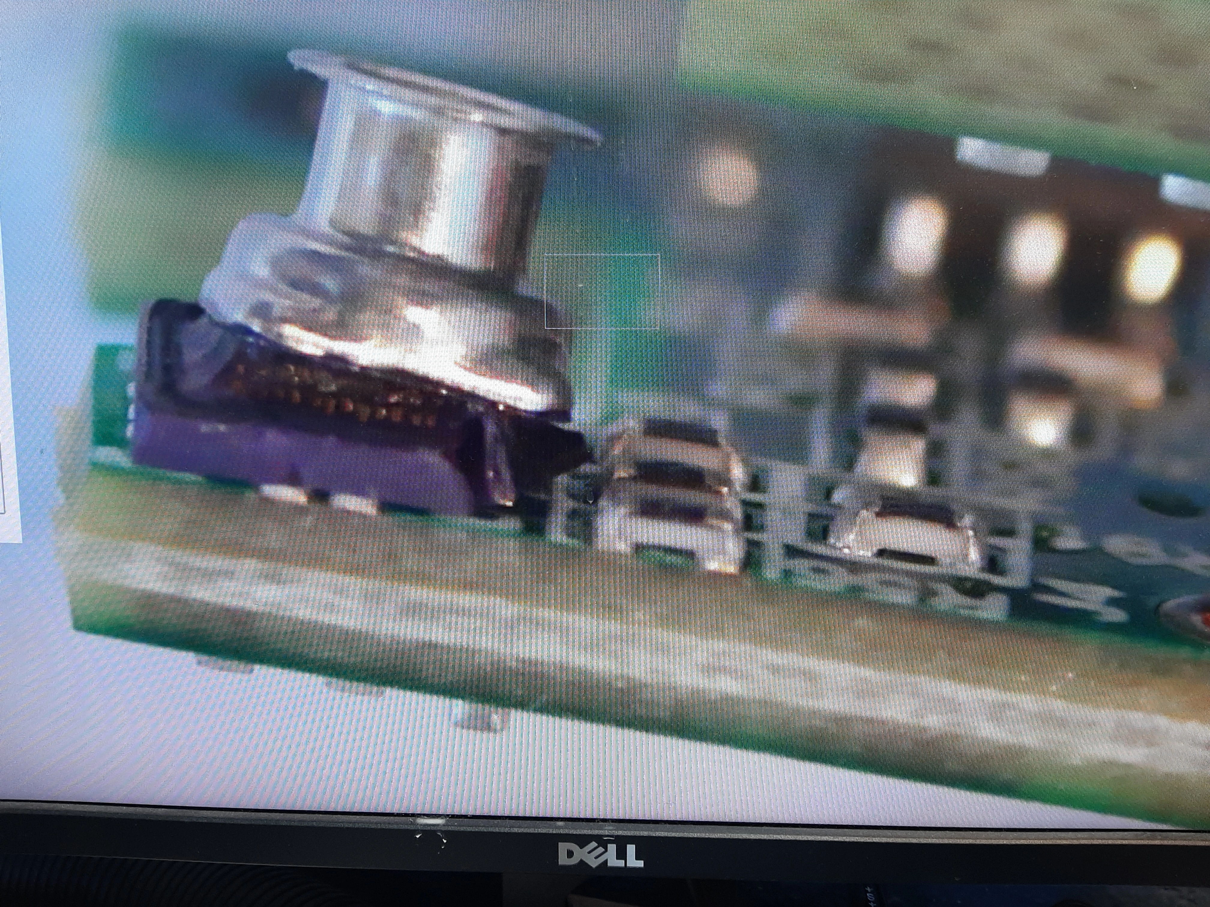

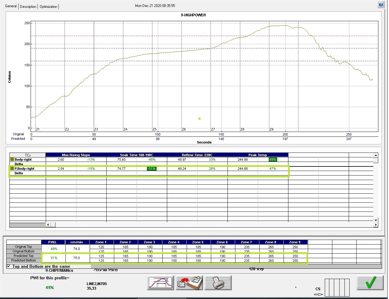

According to the DS of the LPS33W - the Reflow profile should be according to JEDEC J-STD-020 , with no actual determination of the profile.
we had several boards assembled , and with very little force applied, the sensor disintegrated - the metal part from the plastic socket.
I suspect it might be the reflow profile that weaken the glue and caused this disintegration.
Is there a recommended profile for the LPS33W?
We have used before that the STEVAL-MKI205V1 - which is the LPS33W EVB ,
And had no such issue.
The pic below is of an actual reflow performed on the boards.
Thanks.

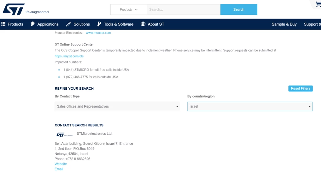

    Hi @SGano.1​ ,
    I suggest you to contact a representative from your region the from the st.com contact page, to get more support and internal visibility -and eventually escalation- on this quality issue.
    -Eleon

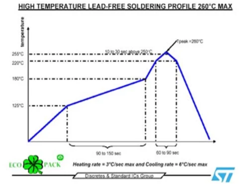

    Which soldering technique are you using (convection / vapor phase)?
    The profile looks overall good, especially in the first part.
    However, comparing it with the one in AN4450 application note (Hardware and software guidelines for use of LPS25H pressure sensor... well it's another pressure sensor but the soldering profiles are all very similar):
    0693W000007DEs6QAG.pngI would suggest you to increase the speed of cooling ramp from 1°C / sec as in your case to at least 2°C/4°C / sec as in the above picture.
    Moreover, in AN4450 application note you can find other considerations to be taken into account:
    In using non self-cleaning solder paste, proper board washing after soldering must be carried out to remove any possible sources of leakage between pads due to flux residues. However, take care not to perform the cleaning process on top of the pressure sensor.
    Let me know if you can try the modified solder profile.
    -Eleon

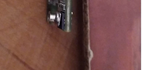

    SGano.1
    SGano.1Author
    Feb 1, 2021 1:49 PM UTC
    Hi @Eleon BORLINI​ ,
    All the LPS33W that were assembled, have Disintegrated.
    Just a little touch disintegrates the Sensors.
    Moreover - after a rework process for replacing the faulty component - two components gave false data (80mBar ambient pressure instead of 1010mBar, and false data of temperature too.
    The I2C comm is OK and the sensor communicates with the uC- but gives the false data.
    Attached another pic from another Board.
