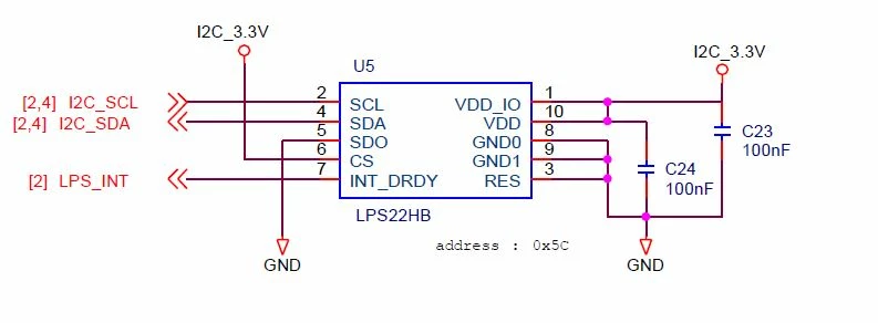

LPS22HB address?
Hi.
I'm testing pressure using LPS22HB IC.
I connect GND SD0.
But LPS22HB give me address nack.
So I change address "Low" to "High", LPS22HB give me strange pressure value and not address nack.
Why do LPS22HB address strange?
Thank you.

    Address would be 0xB8 on architectures like the STM32 where the I2C address is considered the high order 7-bits
    0xB8 = (0x5C << 1)

    Thank you answer.
    I know your answer.
    My MCU transmit 0xB8, but LPS22HB dosen't ack.
    So transmit 0xBA, LPS22HB transmits ack and pressure value.
    But pressure value is strange value.

    Hi @JLee.21​ , which I2C pull-up resistors are you mounting on your board? Regards

    Hi, Eleon BoRLINI.
    Yes. I mount I2C Pull-up(4.7k) resistors my boards.
    It is near another IC with using I2C.
    Also i have a question.
    I'm using NRF52832.

    But LPS22HB first pressure and temperature value are 0x00 after booting.
    ctrl_reg(27h) has p_da(0x00) and t_da(0x01).
    Next LPS22HB pressure and temperature value are ok.
    Sometimes LPS22HB first pressure value 0x800 after booting.
    Next LPS22HB pressure value 0x66.
    How should i do?
