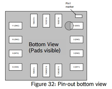

Looking for alternative (drop in) product to BMG250 by Bosch Manufacturer
    2 replies
    Peter BENSCH
    February 3, 2023
    Welcome, @S.VR​, to the community!
    There is no p2p and drop-in alternative, but you can have a look at the I3G4250D.
    If the problem is solved, please mark this thread as answered by selecting Select as best, as also explained here. This will help other users find that answer faster.
    Good luck!
    /Peter
    Eleon BORLINI
    February 3, 2023
    Hi @S.VR​ ,

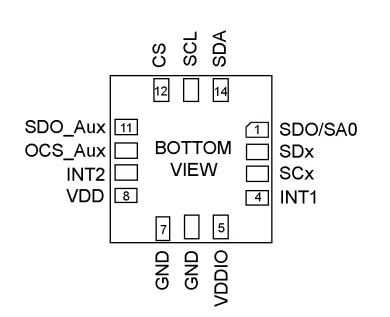

    alternatively, you might consider the LSM6DSO(X) device (which is an IMU, so axl + gyro).
    Both have the same package dimension (2.5mmx3mm, LGA 14L) and pinout.
    Bosch BMG250, see datasheet p.60:0693W00000Y9vIVQAZ.png
    ST LSM6DSO(X), see datasheet p.6:
    You might need some minor software changes.
