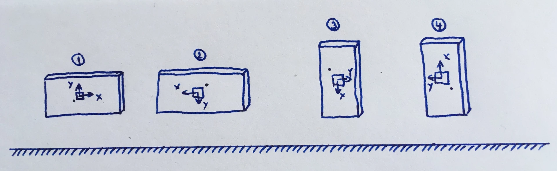

    If you enable only X and Y axis following positions will be detected.
