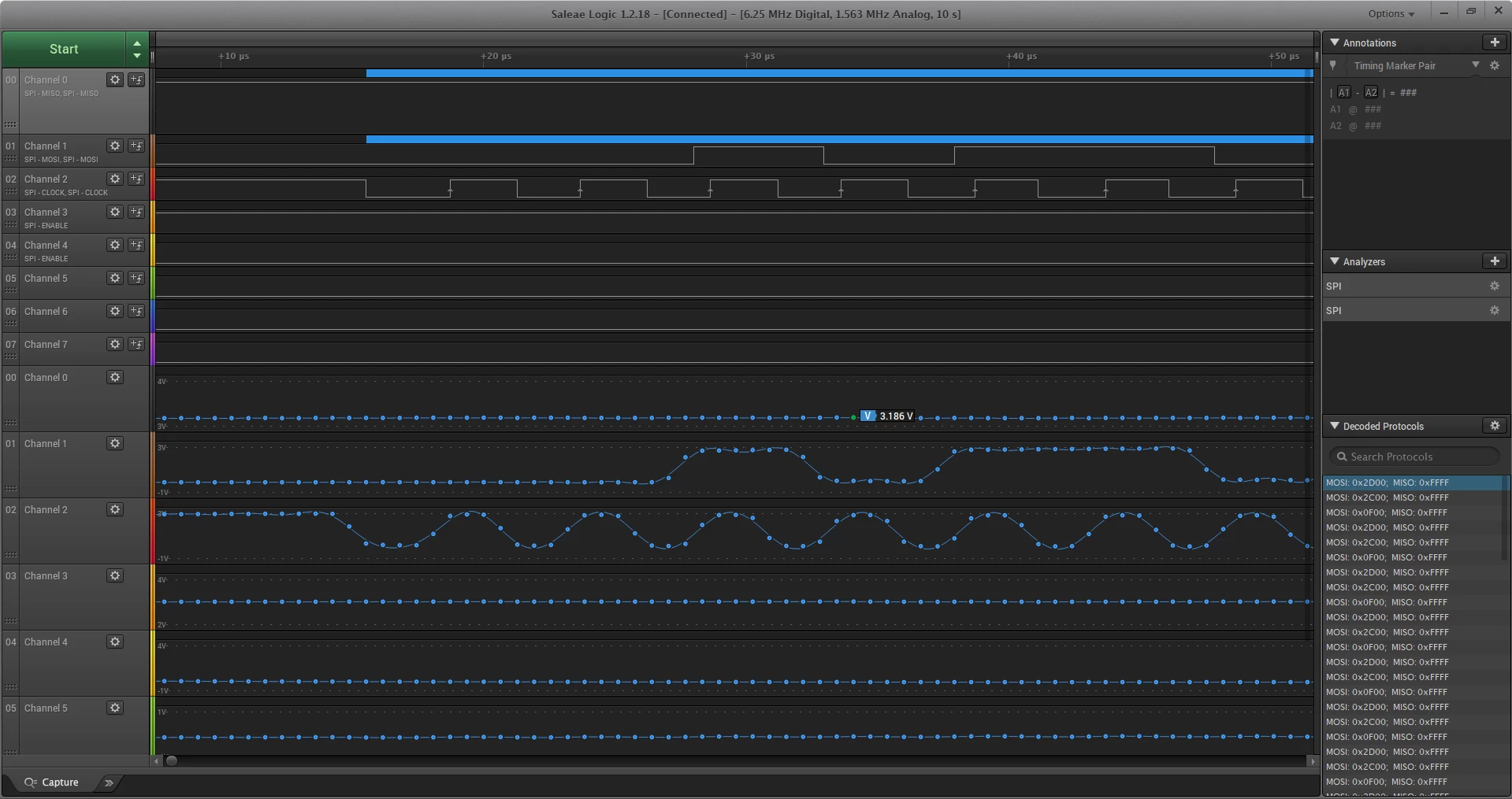

I'm trying to simply read WHO_AM_I (0Fh). OUT_Z_L (2Ch) and OUT_Z_H (2Dh) registers. But output data is only FFh. Also other registers too. What is the data sequence for simple read function? My SPI bus output is MSB first and clock idles low. For WHO_AM_I I'm sending 0F00h.

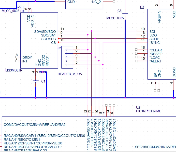

My schematic and SPI bus views is in the attachement.
Thanks in advence for your support.

Hi @AAYKA.1​ , which are the Vdd and VddIO levels in your application? Are you pulling down the CS when you start the SPI communication? Regards
AAYKA.1
AAYKA.1Author
January 29, 2020
Hi Eleon,
Vdd and VddIO levels are 3.3V. ​ CS pin is low before start the SPI communication.
Eleon BORLINI
January 29, 2020
Is the master SPI interface well configured? I mean for example the SPI datasize, the SPI polarity, the SPI phase/edge, etc... Regards

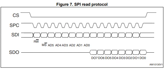

WHO_AM_I (0Fh) register value is 3Dh, while to see the OUT_Z_H varying try to enable OM[1:0] bits in CTRL_REG1 (20h). The SPI read protocol is the following one, so you have to send 16 clock shots and the SDI must contain the bit 0 (R/W) READ bit, which value is 1. For multiple readings the M/S bit has to be 1 too. SO you have to send the value 1F00h for WHO_AM_I reading. Regards
