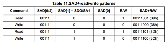

If you use the I2C bus (CS connected to VDD_IO) the pin 9 (SDO/SA1) needs to be connected either to VDD_IO or to GND and it definesonebit of the device address.

‌ Are u sure? Have you connected 4 lis3mdl sensors on one I2c bus?
as mentioned on page 17 of datasheet it has only 2 address(
00111x0b
) so only 2 sensors can be on one i2c bus

Yes i am sure.
For static addresses it is right that only 2 sensors can be used at one IIC bus. But if you connect the SDO/SA1 pin of the sensor to a GPIO pin of the MCU you can switch dynamically the addresses and with this fact you can connect as much sensors as you want (and you can drive the capacity) to the bus. The one sensor you will talk to get the address
0011100b all others 0011110b later you switch your GPIOS and this Sensor get 0011110b and the new one you will talk to get 0011100b and so on.
