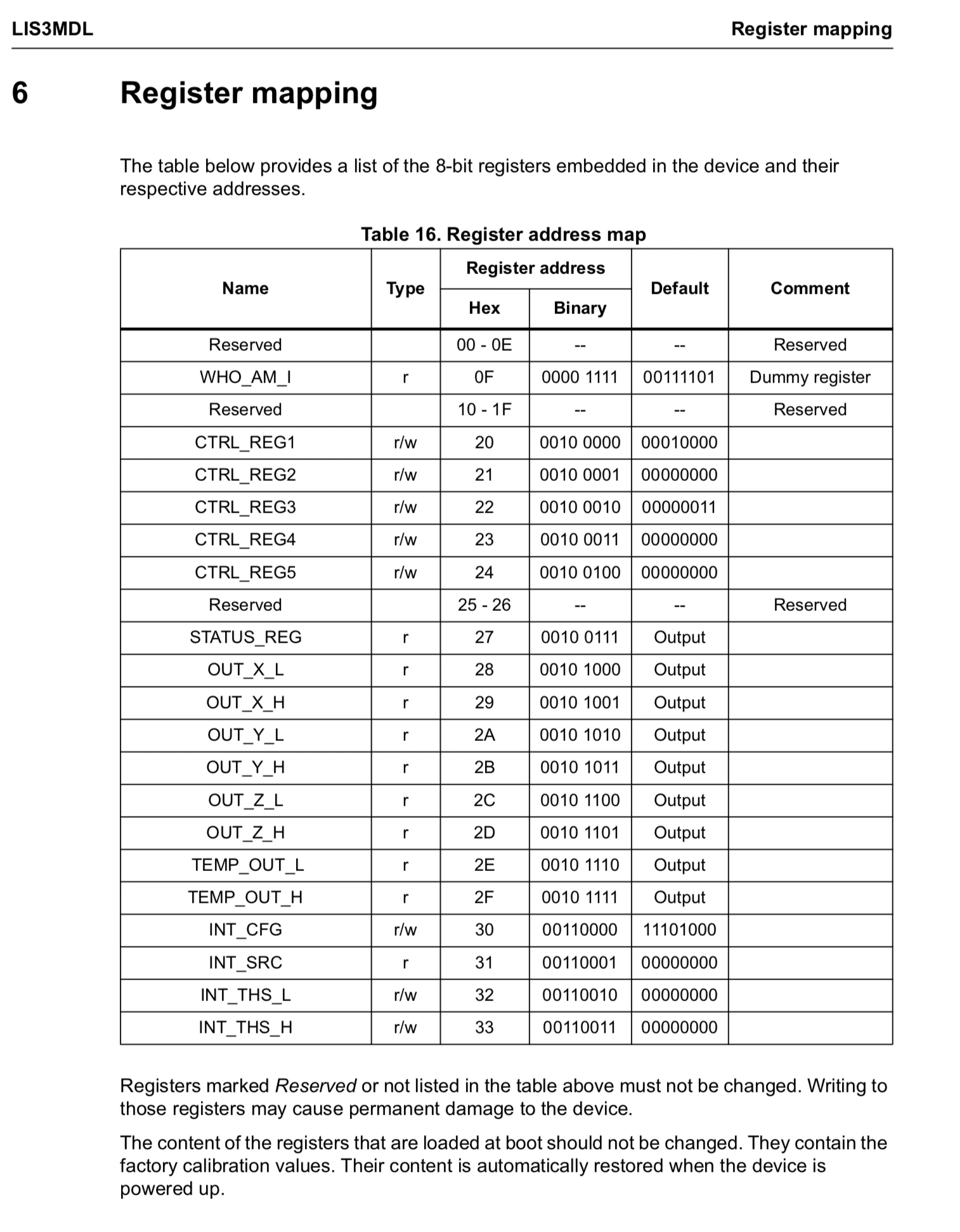

the datasheet for the LIS3ML does not mention any dedicated offset registers that can be used to deduct an offset vector from the measurements:

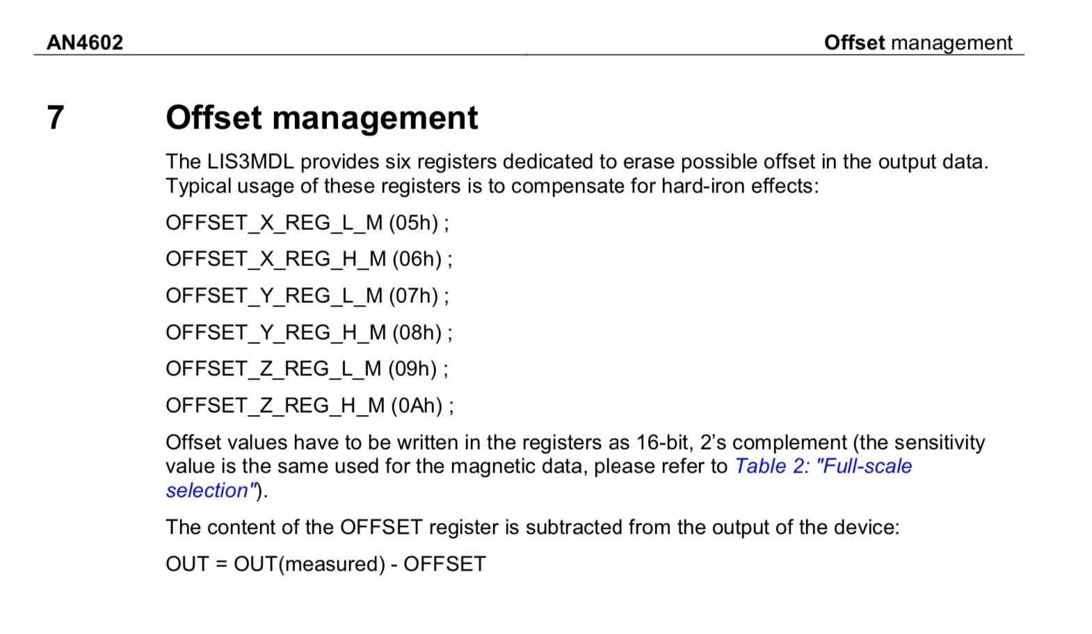

However, when I view the LIS3MDL app note, it says they are there:
The app note points to 05h through to 0ah. According to the datasheet, these registers are reserved.
I tried them out and wrote zero values to 05h ... 0ah . After that, my X axis reading become really messed up!
Is the app note wrong? or the datasheet? Please indicate what can be done with the offset, apart from deducting the offset vector in the application in the microcontroller.

Hi @onderdelen ,
Sorry for this confusion, you can refer to the Application Note.
I don't know why those registers are reserved in the DS but thank you for notice me this error, we will release a new DS version soon.
