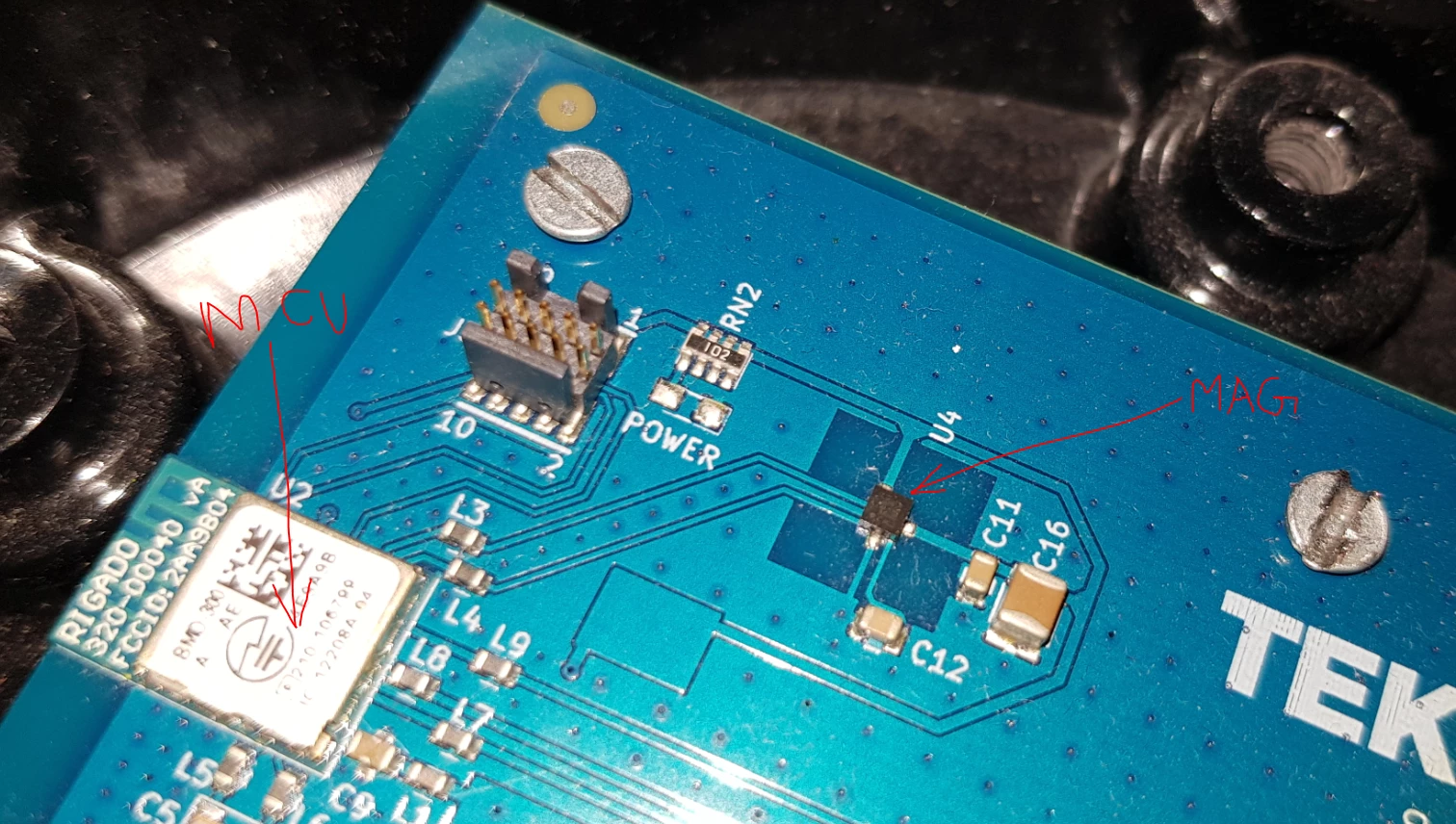

    AMans.1053
    November 1, 2019
    Hi Eleon...one more thing that I thought to share with you....the MCU uses a DC-DC converter which is built inside the module. Would this cause this issue?0690X00000ArWlAQAV.png
    AMans.1053
    November 1, 2019
    Distance between MCU and MAG is 23mm
    Eleon BORLINI
    November 12, 2019
    Hi @AMans.1053​ , the MCU and magnet are quite close, but anyway safe... Is it possible for you to synchronize the magnetometer acquisition and DC-DC converter action in order to check if the issue can be related to a cress-talk between the two chips? Regards
