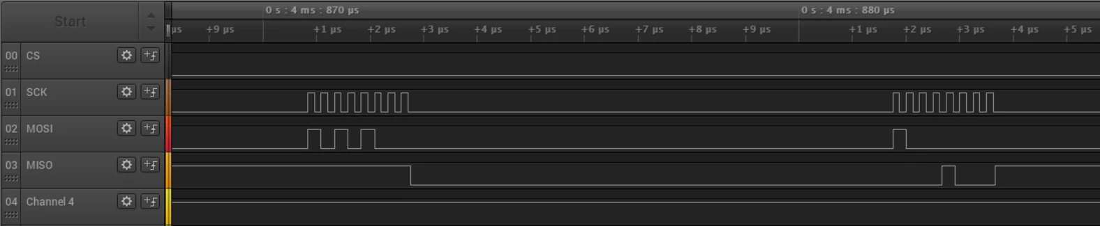

I have tried to work with LIS3DSH sensor using SPI protocol. I applied procedures on STM32L0 Discovery kit LoRa. But it didn't work.
My problem is The LIS3DSH x-y-z-axis output value is invalid and the value is not changed. No matter which direction I rotate the device but I check ID of LIS3DSH is correct ( 0011 1111)

X L axis (adress 0x28)
0693W000008wqGTQAY.pngX H axis (adress 0x29)

Hi @PChar.1​ ,
If you are able to correctly read the WHO_AM_I value, but the data out are all 00h (or FFh? or fixed to a certain value), there might be an issue related to the configuration of the device, especially in the initialization procedure.
You correctly used the LIS3DSH initialization in the application note AN3393, so I would suggest you to check if these registers have been correctly written by reading them after their setting.
You can also check the C drivers on Github repository, for example the lis3dsh_read_data_polling.c. In particular, here the ADD_INC bit of register CTRL_REG6 (25h) and the BDU bit of CTRL_REG4 (20h) registers (so, 6Fh instead of 67h) have ben set.

Hi!
Polarity of SPI clock is actually HIGH. Set CPOL = 1 in your SPI configuration, then it should work :).
Also word size is 16 bit, look at datasheet figure 7.
Correct config for SPI is:
CPOL = 1
CPHA = 1
Word size = 16 bit
