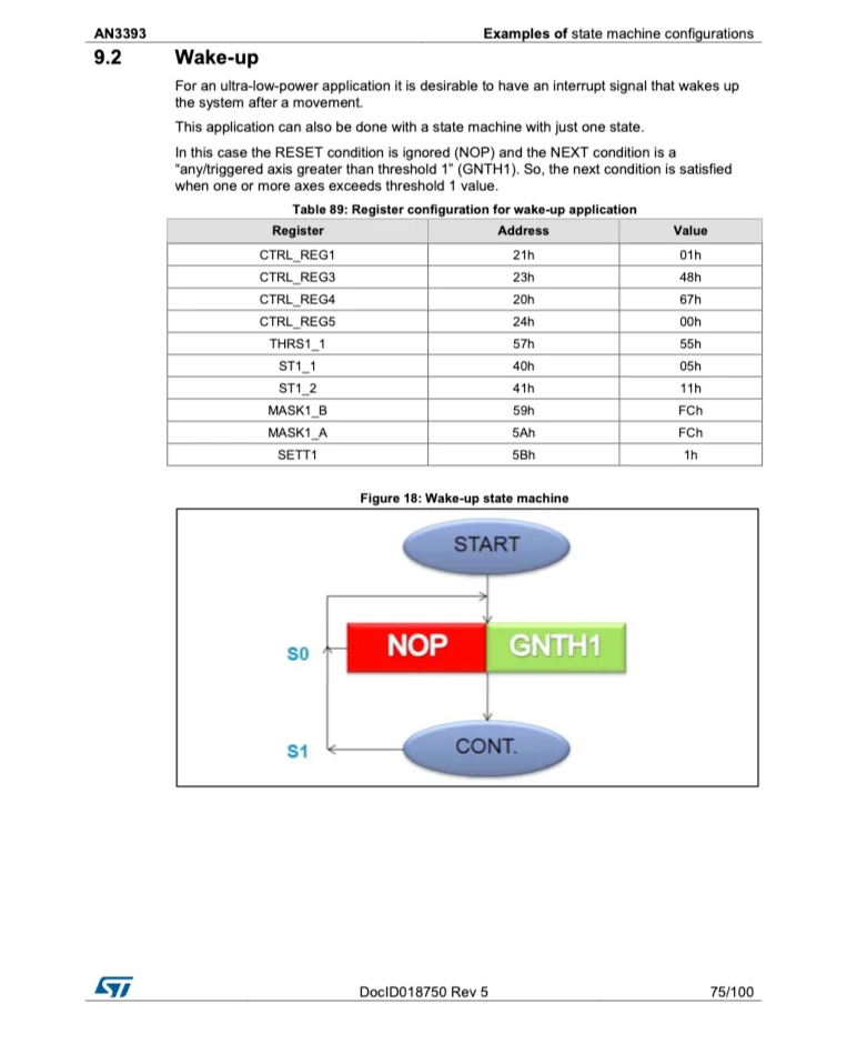

Hello all,
I have set up the "Wake-up" example that you propose on page 75 of the technical documentation (see attached picture).
My problem is that the interrupt during a movement is executed only once. How can I make sure that an interrupt is generated at the next movement, and that the "internal program" of the accelerometer is executed in a loop and not only once?
Thanks :smiling_face_with_smiling_eyes:

    Hi @Rgerg.1​ , I think you have some different ways to get a wake-up interrupt loop:
    • use the instruction command CONT;
    • you could insert the state machine in a while loop (via software);
    • use the State Machine 2 as a sub-routine of State Machine 1, which can be executed multiple times (as shown in the AN3393 p.61), but is a complex way to manage multiple wake-up interrupts...
    • you could check these slides if there is something interesting for you.
