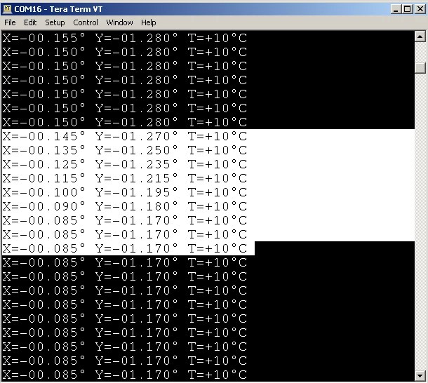

    In the meantime I give yout another example on how data changes dramatically and suddenly without any motivation
    Moreover, this behavior happens going down only with the temperature and NOT going up
    Thanks in advance

    Miroslav I've found the problem.
    THE RESIN PROCESS ON THE ACCELEROMETER MAKES THIS STRANGE BEHAVIOR.
    UNBELIEVABLE
    Usually I did the process for all other accelerometer that I used in the past
    Probably this time the resin was to hard and with a different thermal coefficient so it stressed the accelerometer position makes this sort of offset.
    I don't want what to say. Sorry to everyone for the time that I made you lose.
    Now I will do some other tests in order to be sure that this is the right solution for my application.
