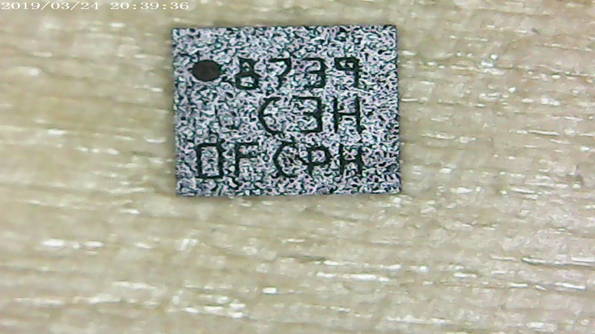

LIS3DH wrong address?
I got some LIS3DH that are not responding to 0x19 neither 0x18... When I run a I2C sniffer, it finds a device on 0x09...
Just wondering if someone can confirm the attached component is a LIS3DH?

LIS3DH in is LGA16 3x3x1mm package, this square component.
Your device seems to be rectangle so it is not LIS3DH.

Thanks for the answer, the component is square, LGA-16 3x3mm... It just looks rectangular because I took a picture in angle in order to show the labeling.
Thanks
