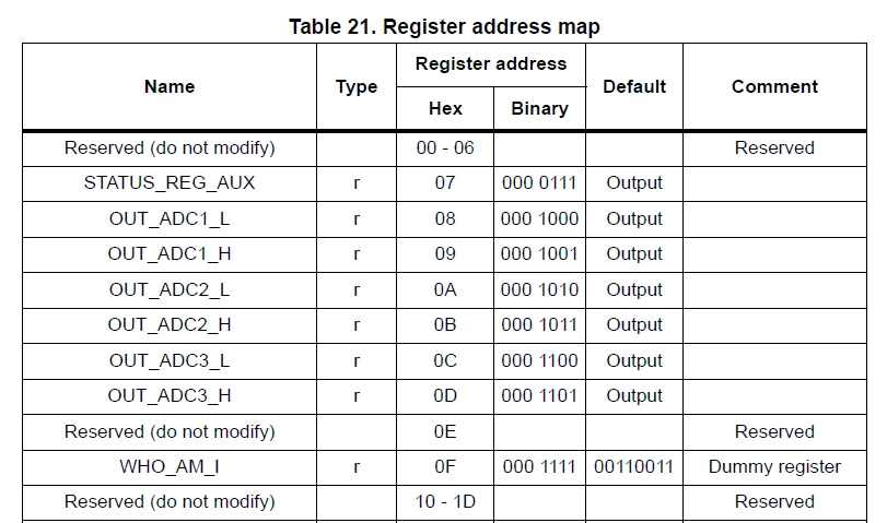

Please do not try to change the content of the reserved registers (like register 0x10) as recommended the Datasheet.0693W00000UolrMQAR.pngFoued

"Writing to those registers may cause permanent damage to the device.
The content of the registers that are loaded at boot should not be changed. They contain the
factory calibration values.
Their content is automatically restored when the device is powered up." (7. Register mapping (Datasheet LIS3DH))

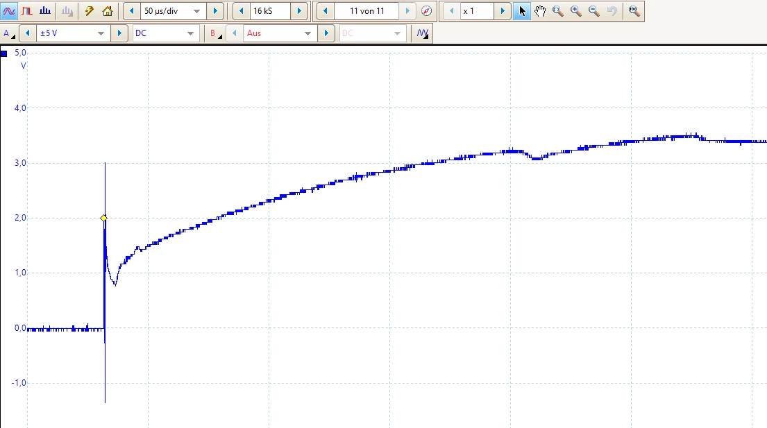

The REG 10h is a reserved register, which refers to a coarse calibration, but you should not see the X axis stuck if this register is failing at boot. You might try to characterize the power on event (Vdd ramp, level, Vddio): for example, it is better to keep Vdd and VddIO are suggested to stay at the same level (>2V)

Unfortunately we face the issue on most, but not all of our boards.
Sometime a board working ok for a while starts to show the strange behaviour without any writes to the reserved registers.
Find below a picture of the Vdd ramp with Vdd = 3.3V, time resolution 50us/div, so after approx. 200us Vdd is stable. Vdd and VddIO are directly connected, as we use a STM32L476RG Nucleo Board with 3.3V on SPI or I2C signals respectively. In my Software I have a 100ms delay before accessing the device for the first time, configuration see in my first post.
I assume that there is a HW or SW problem in our design as the LIS3DH is on the market for years, but I have absolutely no idea what we are doing wrong.
