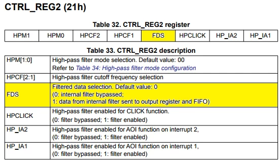

Hi All.
I want to configure the filter in such a way that the data in the out registers are not filtered, and the data for interrupt AOI are filtered. But I have filtered data in both the interrupt and the output registers.
My settings of filter: AX_Write (0x21, 0xC1);
Whats wrong?

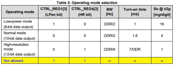

    OK, I see.
    First of all, you use not allowed configuration:
    Please set the HR bit in CTRL_REG4 to 0, it should start to work as expected.
    I will check if the "Autoreset on interrupt event" mode can work also in Normal and High-resolution mode.

    If the FDS bit is 0 the in output registers are without high-pass filter.
    Can you read back the CTRL_REG2 value and confirm the configuration?

    "If the FDS bit is 0 the in output registers are without high-pass filter." - that's the question!
    I read back all the registers that have been configured. The read data is the same as what was recorded.
    Here are all the settings:
    AX_Write (0x20, 0x3f);
    AX_Write (0x22, 0x40);
    AX_Write (0x23, 0x8);
    AX_Write (0x32, 10);
    AX_Write (0x33, 0x00);
    AX_Write (0x30, 0x2A);
    AX_Write (0x24, 0x00);
    AX_Write (0x2E, 0x00);
    I calculate the angle by acceleration, after the interruption the filter is reset and the calculation of the angle becomes incorrect. If I use AX_Write (0x21, 0x00); angle is calculated correctly. However, I cannot use this setting, because along with the angle I need to detect the presence of movement, and for this I use an interrupt and a filter in Autoreset mode.
    November 12, 2018
    Can you share a data which you read with the configuration 0xC1 in register 0x21 in case the device is steady?

    OK, I see.
    November 19, 2018
    One more thing:
    "Autoreset on interrupt event" high-pass filter mode can work in High-resolution sensor mode only if FDS bit is set to 1. In case accelerometer raw data (not high-pass filtered) are needed on output data registers, Normal or Low Power mode has to be used.
