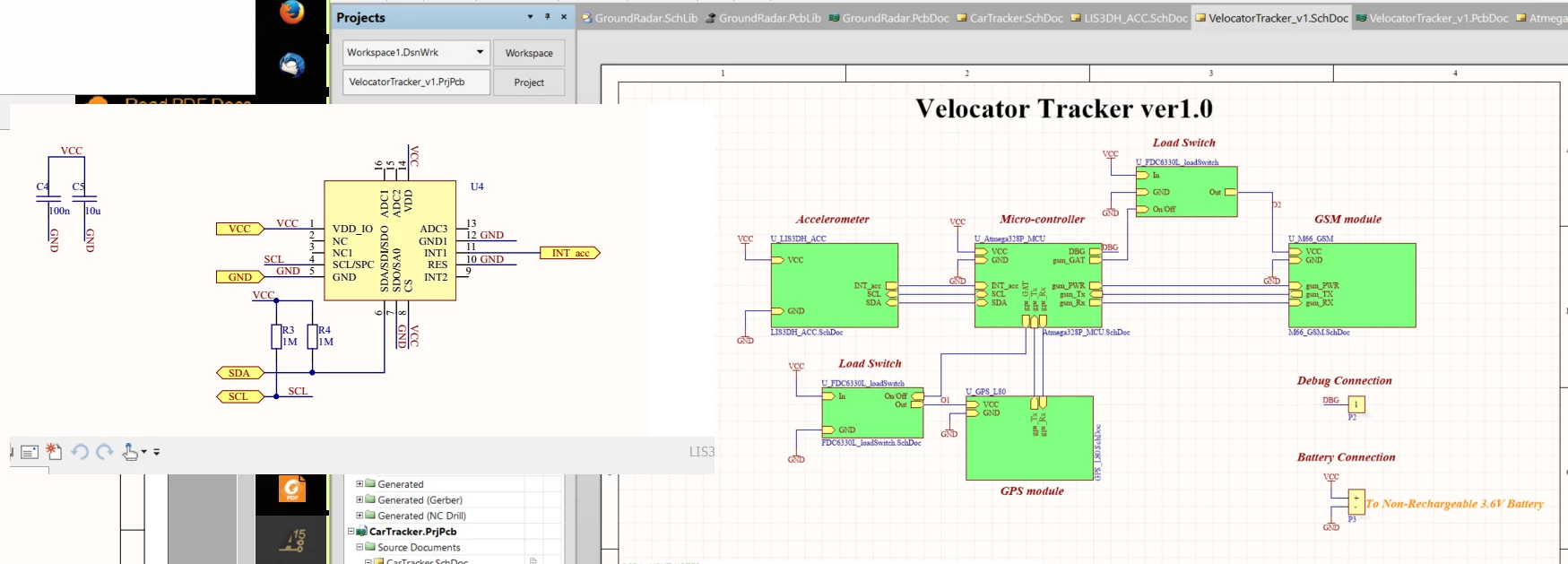

I'm using LIS3DH accelerometer in my current design. I need it to detect the movement.
ODR is set to be 10Hz. According to
http://www.st.com/content/ccc/resource/technical/document/application_note/77/ed/e7/e1/28/5a/45/d6/CD00290pdf/files/CD00290pdf/jcr:content/translations/en.CD00290pdf
document (page 10), LIS3DH should consume about 4uA of the current in both Normal and Low power modes.
However, when I measure the current consumption, I get the value of about 78uA (@2.5V power supply). When I remove the accelerometer from the power rails and measure the current consumption of mcu in a sleep mode, I get the value of 3.2uA. This clearly implies that about 75uA of the current is consumed by the accelerometer.
The important thing to mention here is that I was supplying the mcu and accelerometer with 3.7V to 4.2V for some time. This is above the recommended supply range for LIS3DH (3.6V maximum). So, is it possible that this over-voltage permanently increased the current consumption? I have the desired functionality even when I supply the system with 3.7V to 4.2V.
Thank you very much for your time and effort.

Anyway can you please share you schematic, at least the sensor part, I can look at it.

Posted on January 16, 2017 at 17:00
Hello Miroslav,
Thanks for your prompt reply. Of course I can share the schematic with you.
As you can see, I have two external pull-ups for I2C. I used 10Mohms to additionally reduce leakage current and it I2C is working properly with them. Between MCU and the accelerometer, there is only I2C interface.
Is there anything you can suggest me? How could I disable internal pull-ups?
Thanks in advance,
Bojan.
January 16, 2017
Posted on January 16, 2017 at 17:11
There will be a current from SDO/SA0 pin to ground in your circuit, because you connected the pin to ground. According to datasheet the current should be higher than 70uA, but anyway try to disable the internal pull-ups in CTRL_REG0 register. Please check chapter 8.6 in the datasheet.
The pull-up for SDA/SCL are very high, you could have a problem with the communication. The recommended value for I2C pull-ups is 10kohms.
