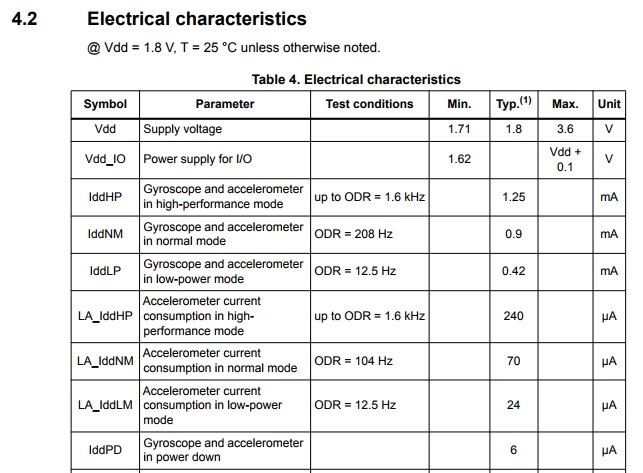

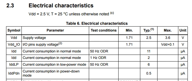

Regarding the power consumption:
Here is an extract from
http://www.st.com/content/ccc/resource/technical/document/datasheet/3c/ae/50/85/d6/b1/46/fe/CD00274221.pdf/files/CD00274221.pdf/jcr:content/translations/en.CD00274221.pdf
And similar for the
http://www.st.com/content/ccc/resource/technical/document/datasheet/a3/f5/4f/ae/8e/44/41/d7/DM00133076.pdf/files/DM00133076.pdf/jcr:content/translations/en.DM00133076.pdf
It seems that the gyroscope adds significant amount of power consumption compared to just an accelerometer. Also, as low Vdd as possible is needed.
I am not sure I fully understand the test situation you described. 0.1 g triggeres an interrupt, but 0.8 not? Could you share the code or values that you use to set the control registers?
David
