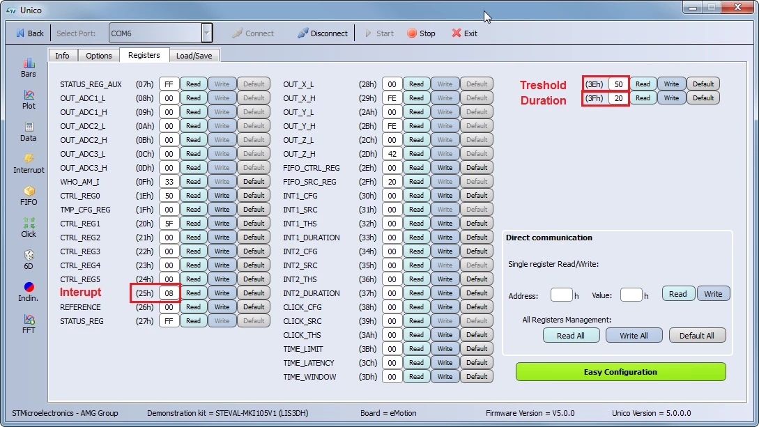

May 19, 2017
Posted on May 19, 2017 at 14:48
The activity/inactivity detection is functional.
I think the problem is in your configuration, you set the threshold to
250 mg which is always below the 1g caused by the gravity. If you sent it above the 1g it should start to work. Please see my configuration below, I highlighted the settings related to the functionality.
I think the functionality is available even in old components (before
Jan 2017), I tested it with older one. It was only not exposed in the datasheet.
Anyway I will double check this information.
neil young
May 19, 2017
Posted on May 19, 2017 at 16:21
Well, I also excluded Z (for the 1 G) and made attempts with the HP (differential approach)
Anyway: Your config, as long as it matters:
CTRL_REG0         0x50
CTRL_REG1         0x5F
CTRL_REG6         0x08
Rest does not apply, except
ACT_THS               0x50
ACT_DUR              0x20
I'm pretty sure to have tried that or something similar, maybe I used 0x2F for CTRL_REG1 and didn't activate pullups, because they are external. But will try again. I was trying to read INT2 status by polling INT2_SRC to no avail. Always 0

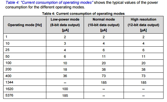

May 25, 2017
Posted on May 25, 2017 at 12:50
I think it deepens on your application requirements. The latency can be important for some application.
The advantage of the activity/inactivity feature is that it is managed automatically by the sensor.
For current consumption please check the following table from application note.
neil young
May 25, 2017
Posted on May 25, 2017 at 15:36
OK, what I wanted to say is: The free fall abuse allows me to stay at 1Hz low power all the time, which results in 2 uA overall power consumption, regardless of activity or inactivity.
The Actvity/Inactivity detection as outlined above _automatically_ stays at 10 Hz low power, which means 3 uA in inactivity phases.
