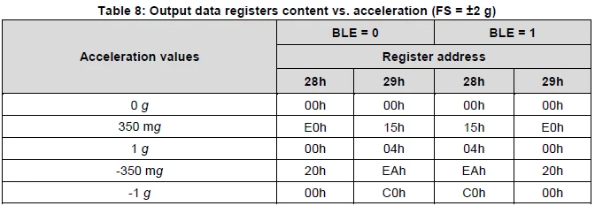

In an attempt to better understand the process I have been working with AN3308 Table  8 Example of Acceleration Data. I worked on the +350mg and -350mg examples and they worked as expected:
-350mg = 0xEA2h -> invert -> 0x15Dh -> +1 -> 0x15Eh = {256 + 64 + 16 + 8 + 4 + 2} x -1 = -350 x 1mg = -350mg
350mg = 350 x 1mg = 350mg
However this approach falls apart when working with the +1g and -1g examples. Given the data is held left aligned in two's complement I would have thought the values should have been:
-1g = (-1) / 1mg = -1000 =  0xC18h     BUT it is given as 0xC00h which is -1024.
+1g =   1  / 1mg =  1000 = 0x4E8h      BUT it is given as 0x040h  which is 64.
To top it all off I have seen comments which suggest all that is needed is a shift of the register to correlate with the bit resolution and then simply multiply by the scaler, but surely in two's complement format this will result in all values becoming positive because the MSB has now lost its place?

3. The conversion in the table 8 in AN3308 is correct, maybe the rounding 1.024 to 1g can be misleading. You made one mistake in the following line '
+1g =   1  / 1mg =  1000 = 0x4E8h      BUT it is given as 0x040h  which is 64.'
The value in the table is 0x4000. The output is 12 bit (high-resolution) so you can shift it by 4 bits (or divide by 16) and you will get 0x400 which is 1024.

Aaron Derbyshire
Oct 26, 2017 3:40 PM UTC
Posted on October 26, 2017 at 15:40
Thank you for your reply Miroslav.
1. Good this aligns with what my understanding of what the process was!
2. Okay I was unaware of this, it didn't seem to correlate when I looked into the sections mentioned by previous posts.
3. If that is the case then I am not sure I understand. When we interpret the values for the ±350mg the values are given as:
+350mg: 0x15E0h and for the 12 bit resolution we can drop the read 0x0h to obtain 0x15Eh.
-350mg:  0xEA20h and again we can mitigate the LSB to give 0xEA2h
So why does 0x0400h become 0x4000h?
Thank you for clarifying that the data has also been rounded to obtain ±1g, this may be worth noting in the documentation.
Thank you for your time and comments.

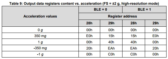

Oct 26, 2017 1:51 PM UTC
Posted on October 26, 2017 at 15:51
Oh, I see, it seems you have old version of the application note with the error.
Please download the latest version of
http://www.st.com/content/ccc/resource/technical/document/application_note/77/ed/e7/e1/28/5a/45/d6/CD00290365.pdf/files/CD00290365.pdf/jcr:content/translations/en.CD00290365.pdf
