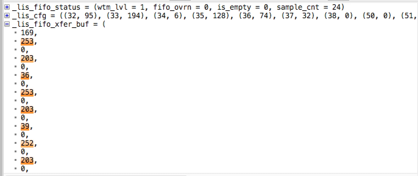

LIS3DE vs. LIS3DH HW FIFO Handling
Posted on June 11, 2018 at 14:55
we've been using the LIS3DH on a development board and have switched to the LIS3DE for the prototype. We're using the HW fifo feature to batch-read values from the sensor. The LIS3DE is only 8-bit and thus I was expecting the HW fifo to only provide 8-bit values, but it seems like it is still sending 2 bytes per axis, is this correct?
The reason I'm asking is simply due to the fact that the _L and _H distinction does not exist on the LIS3DE, I'm always reading from register 0x29 (instead of 0x28) and read using auto-increment. In the received data every second value is zero and thus the values are actually signed 16 bit values?
What is the correct way to interpret the values? Attached: Buffer as read from LIS using HW fifo feature

It is correct, there are two bytes in the FIFO per axis. But the second byte is not used so you can discard it.

Thanks, I did fear that this might be the answer since it doubles the amount of data that i have to transmit via I2C. another question very closely related to this: The LIS3DE also has a 'normal' mode (vs. 'low-power') but always delivers 8-bit values - is there really any difference between these two?
On the LIS3DH the device provides 10 bit in normal mode (instead of 8 bit). The only option affected by this setting on the LIS3DE is the 1.6 kHz mode - is this correct or is there any other use of the normal mode on the LIS3DE?

First difference is the available ODR modes:
Second difference is in current consumption:
In Normal mode the noise will be lower because the sensor does internally an averaging.
