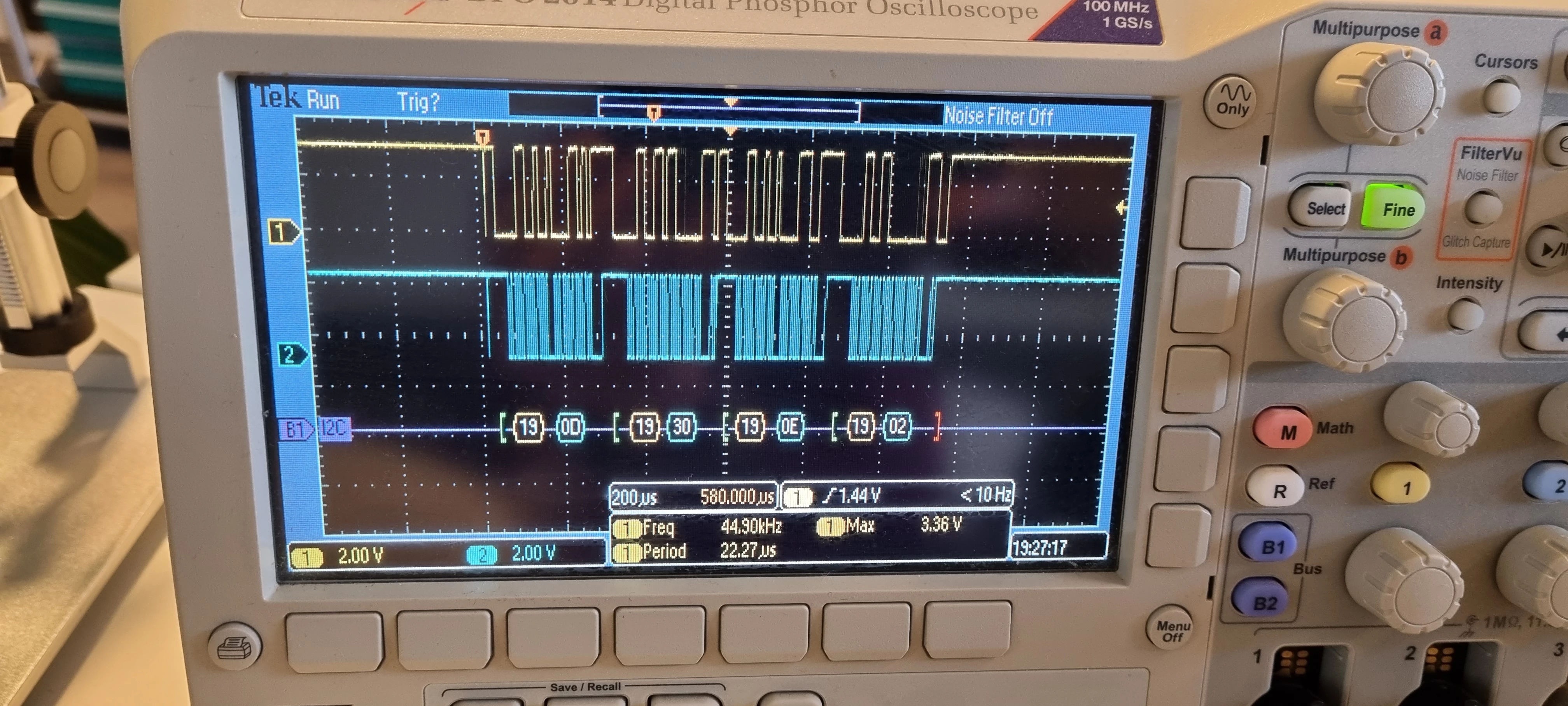

I'm supposing that the refer to IIS2DLPC device, since the temperature registers are 0D and 0E.
The conversion formula gives actually the following:
  • 0230h --> two's complement --> 608dec --> conversion formula --> 38 + 25 deg
That is indeed a little high if you are measuring ambient temperature...

On ambient temperature the IIS2DLPC replies with 0230h, and when I hold my finger on the chip I see register 0E increasing to 05, 06
Does manually heat solder this chip easily damage the internal temperature sensor?
Or did I maybe forget to configure the chip properly?

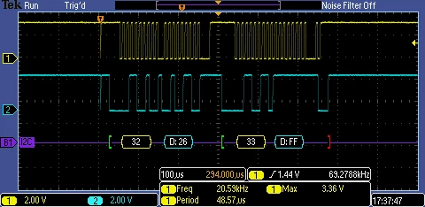

I just tried to scope our project again, but now requesting the 0x26 8 bit register and turned on the scope option to show R/W bit in the decoder
The chip on this board gets its ODR setting etc.
It returns 0xff or 0x00 nothing else.
Maybe my I2C read is not correct?
