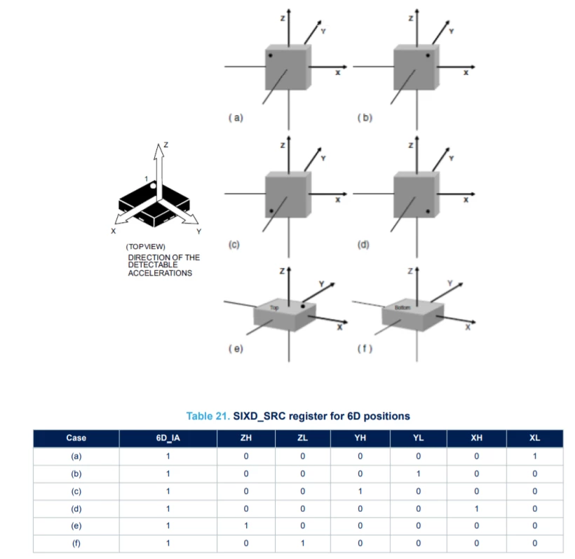

Hello We are working with accelerometer LIS2DW12.
according to the diagram in the data sheet. if the accelerometer is in this state, will we see the zl \ zh orientation bit raised?
Eleon BORLINI
Eleon BORLINIBest answer
Jun 21, 2021 12:18 PM UTC
Hi @Msaga.1​ ,
are you referring to the ZH bit in the SIXD_SRC (3Ah) register, right?
If so, yes, the orientation of the device is given by the sensing of the 1g earth gravity and by default, you could be in position (e) of the following scheme (see application note AN5038 p.24):
0693W00000BbY5NQAV.pngLet me please know whether I correctly understood your question.
-Eleon

Msaga.1
Msaga.1Author
Jun 22, 2021 8:16 AM UTC
yes thank you
