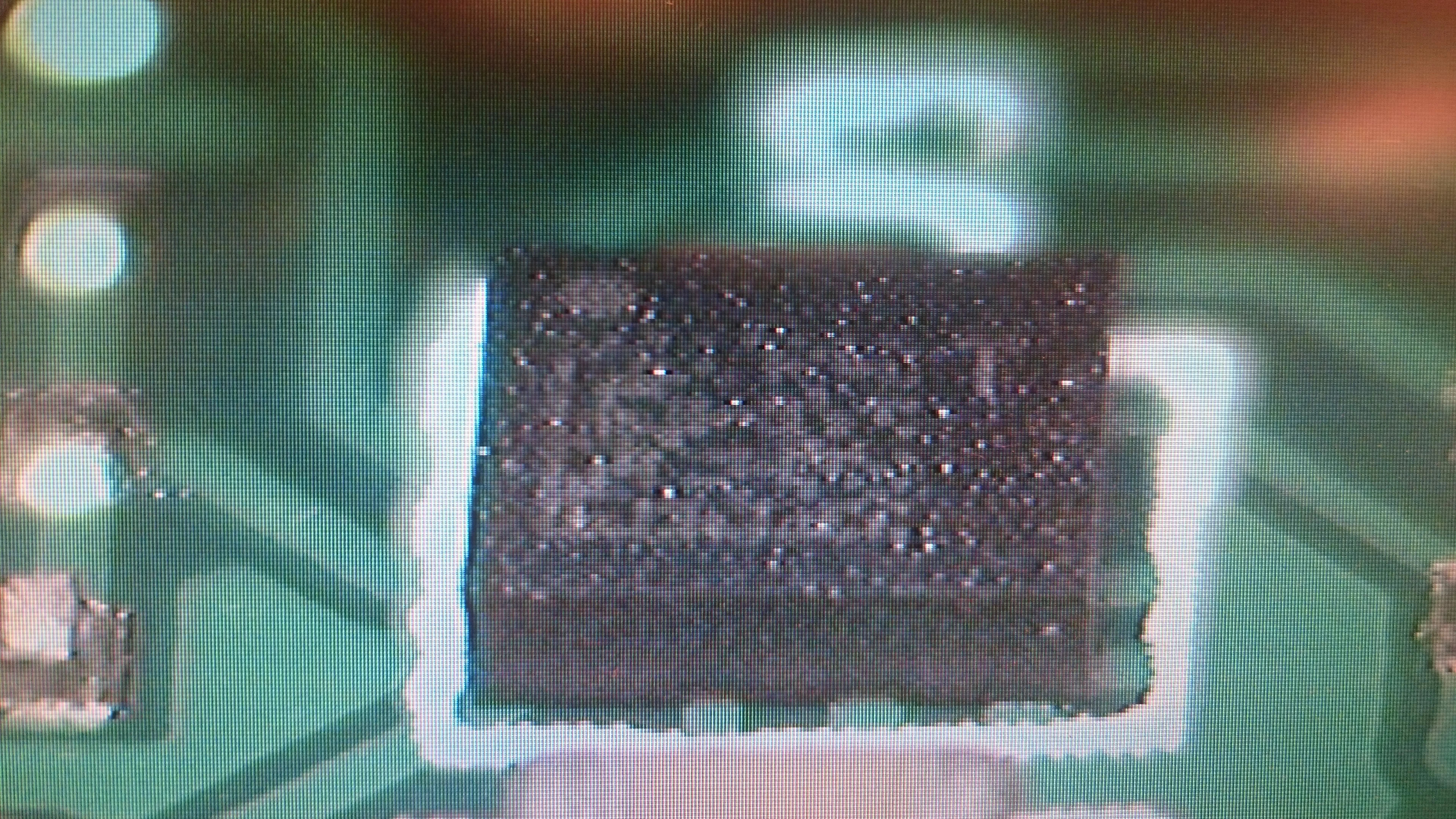

Attached is an image of the mounted sensor were the marking is a dot, a datamatrix and a 'T'.
Thanks in advance for your help.

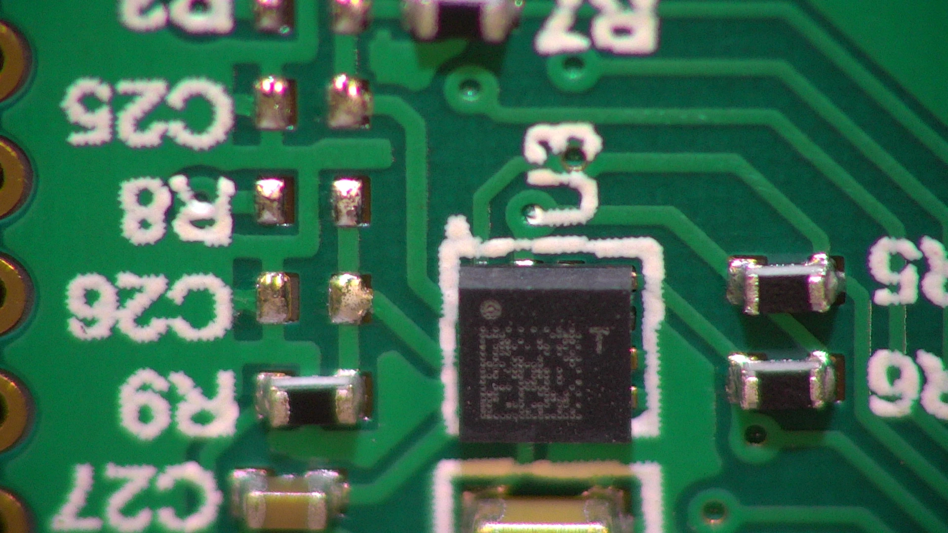

The schematics is OK, but I compered your schematic, the image of your board and pin out in datasheet, I see they are not aligned.
I added the pin description in your picture and I see for example the CS and SDO pins are connect to your interrupt circuit. So most of the pins have wrong connection.
Can you please double check your sensor footprint and layout of the boards?

Here you have a better image:

You are right, the datasheet specifies the pinout seen from the bottom and we didnt realize it.
We have flipped the component and mounted it properly to check that with right connection the sensor works.
