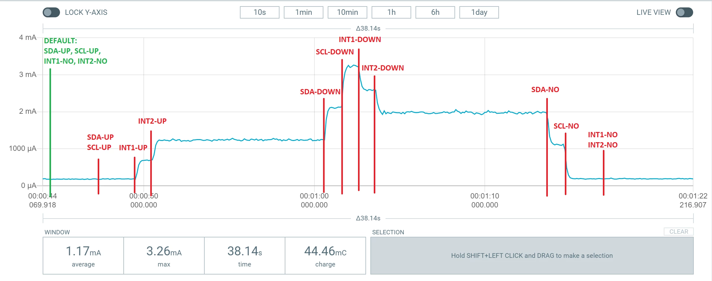

The datasheet of nRF9160 says that the internal pull-up/pull-down resistor values are 11-16kOhms. So do we need to do something to these pins on nRF9160 side?
"We checked the GPIO configurations of all of the pins connected between LIS2DW12 and nRF9160. On nRF9160 side, SDA and SCL pins have internal pull-ups and also INT1 and INT2 pins have no pull-ups. We tried to change the pull configuration for all of those pins and found that the defaults are the correct ones."
Are the default pull configurations correct?
"Also, CS pull-up on LIS2DW12 side is connected by default. We tried to disconnect that pull-up and didn't notice any big change there on power consumption."
Should we disconnect this when using I2C or just leave it as connected as default?

We tried changing the internal pull-ups of the GPIOs on nRF9160. Here you can see the results of the changes:
niccolò
April 28, 2021
Hi, I'll try to answer to all your messages in one shot:
@APaan.1​
you're welcome, I hope I can help you solve the situation =)
let's tackle your questions/answers in order:
  • the capacitor should add noise filtering capability on Vdd, it is good practice to use the ones shown in the application hints
  • I'll try to rephrase my question: how much is current consumption when the sensor is off (ODR bits of register CTRL_1 = 0000) and you try to set some registers? feel free to post the instructions you use (even if I'm not used to nRF Connect SDK, I can try to understand them)
  • this is a strange behaviour, but it does not explain the actual behaviour
  • the power consumption for Vdd at 3V is not available for full disclosure, but the characterization team told me that values are under 1 uA, even for that voltage
@TNiku.1​
  •  on nRF9160 side these pull-ups can delay a little the signal but they should not be able to draw a lot of current
  • the default are the correct ones if you do not add some external hw that changes the situation. the fact that you tried different configuration in your latest message seems to be proof that they are right
  • when using I2C you should always keep CS pin high. an internal pull-up is the reason why disconnecting it does not break I2C communication immediately, but it is not correct to leave it disconnected
