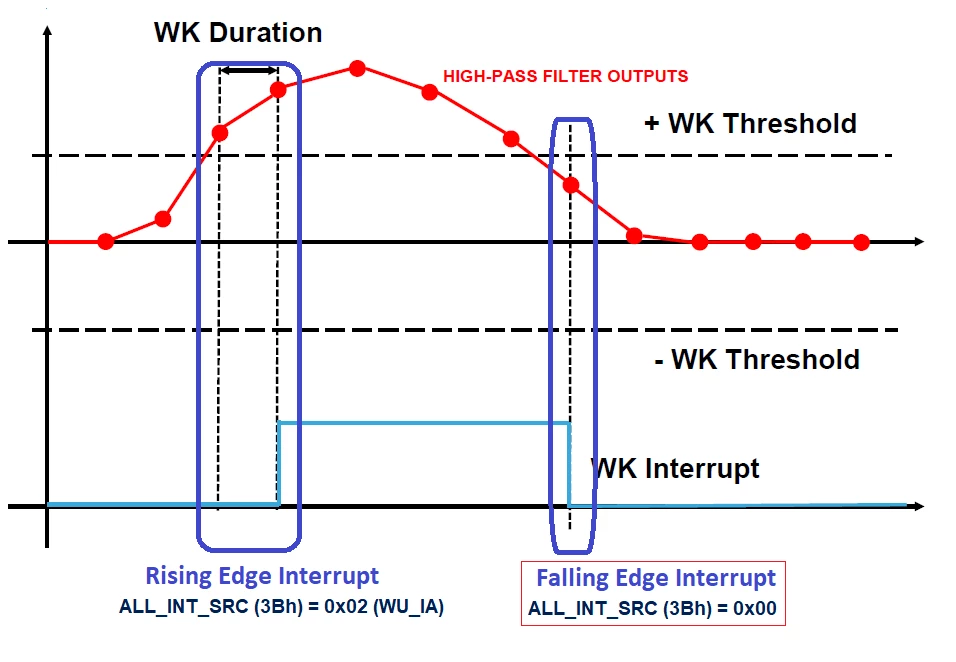

Hello Support Team,
I am working on the LIS2DW12 Sensor with Wake-up feature.
Issue :
Getting Zero on ALL_INT_SRC (3Bh) read while Falling interrupt occurred.

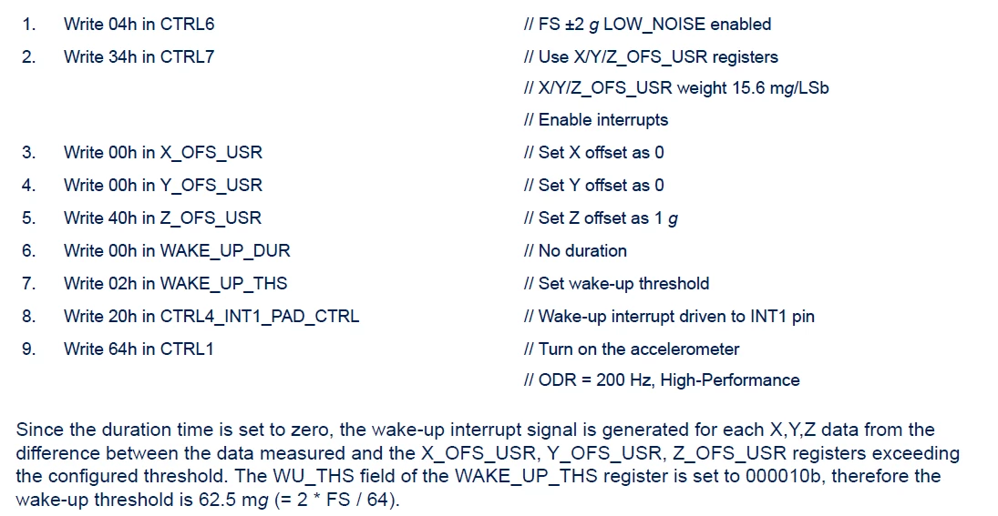

Description :
Configuration :
Operation :
0693W00000Stl9bQAB.pngWhy does Falling Edge interrupt show Interrupt status as Zero?
Request :
  1. Can you please give a reason why the falling edge interrupt status remains zero?
  2. Can you please suggest a solution for the identification falling edge reason (is it due to Wakeup or Freefall)?
  3. Is there any way possible to route Wakeup on INT1 and Freefall on INT2 Pin?
