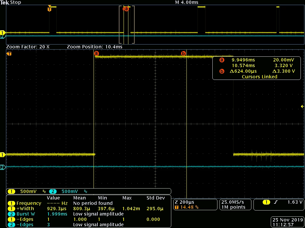

Hello ST-Community!

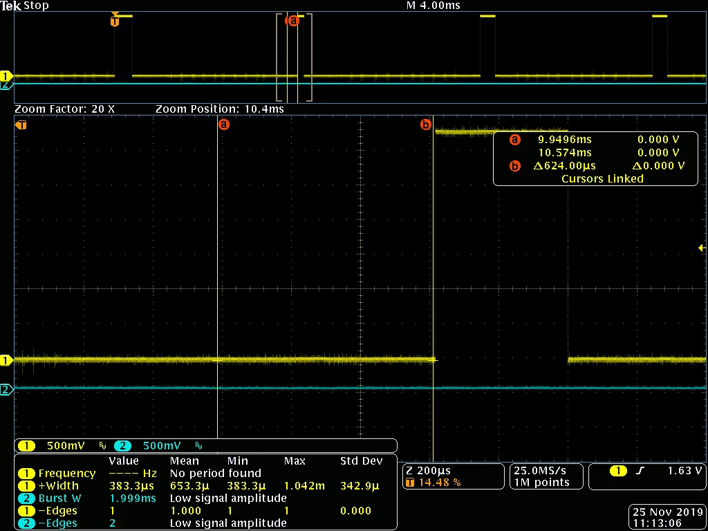

When I'm using the LIS2DW12 at ODR=1.6kHz, the Interrupt for reaching the FIFO-Threshold is jittering with 1/ODR, but only if the threshold is greater than 12. If it's less or equal, everything is working fine.
The buffer-Mode is set to FIFO-Mode, but this behaviour also occurs in Continous-Mode.
The Power-Mode is set to High-Performance/Low-Noise.
The Interrupt is routed to the INT1-Pin
The two images show the rising edge on the pin INT1. The time between the two cursors "a" and "b" is 624us (almost 625us), which would equal to 1/ODR (1/1600 = 625E-6)
As written, this only happens if ODR is set to 1.6kHz and the FIFO-Threshold is greater than 12.
Does anyone have some further informations regarding this issue?
Thanks in advance for your answers!
Greetings,
Loris

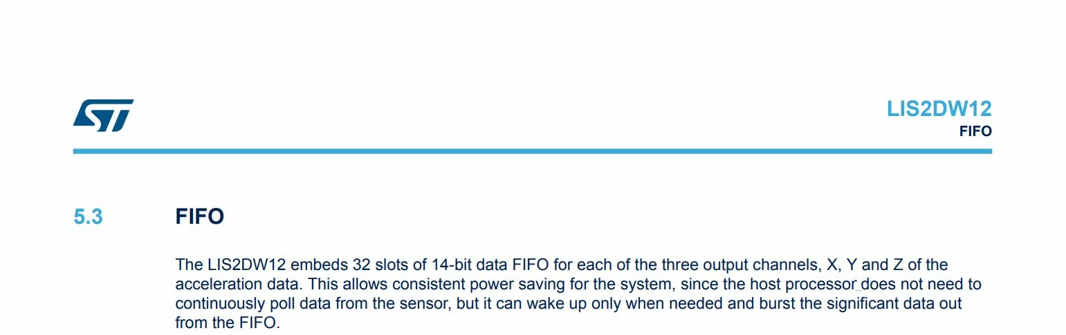

So, if I read your answer correctly, it would mean that I completely misunderstood how the FIFO in the LIS2DW12 works...
From the informations provided by the datasheet I thought, the FIFO would contain only the acceleration data.
Additionly I assumed, that a FIFO-threshold of 12 meant that there is an Interrupt when I have 12 Samples (each consisting of 3 Axis * 2 Bytes/Axis) in the FIFO, which would result in a total of 72 bytes of data.
So... are my thoughts regarding this completely wrong?

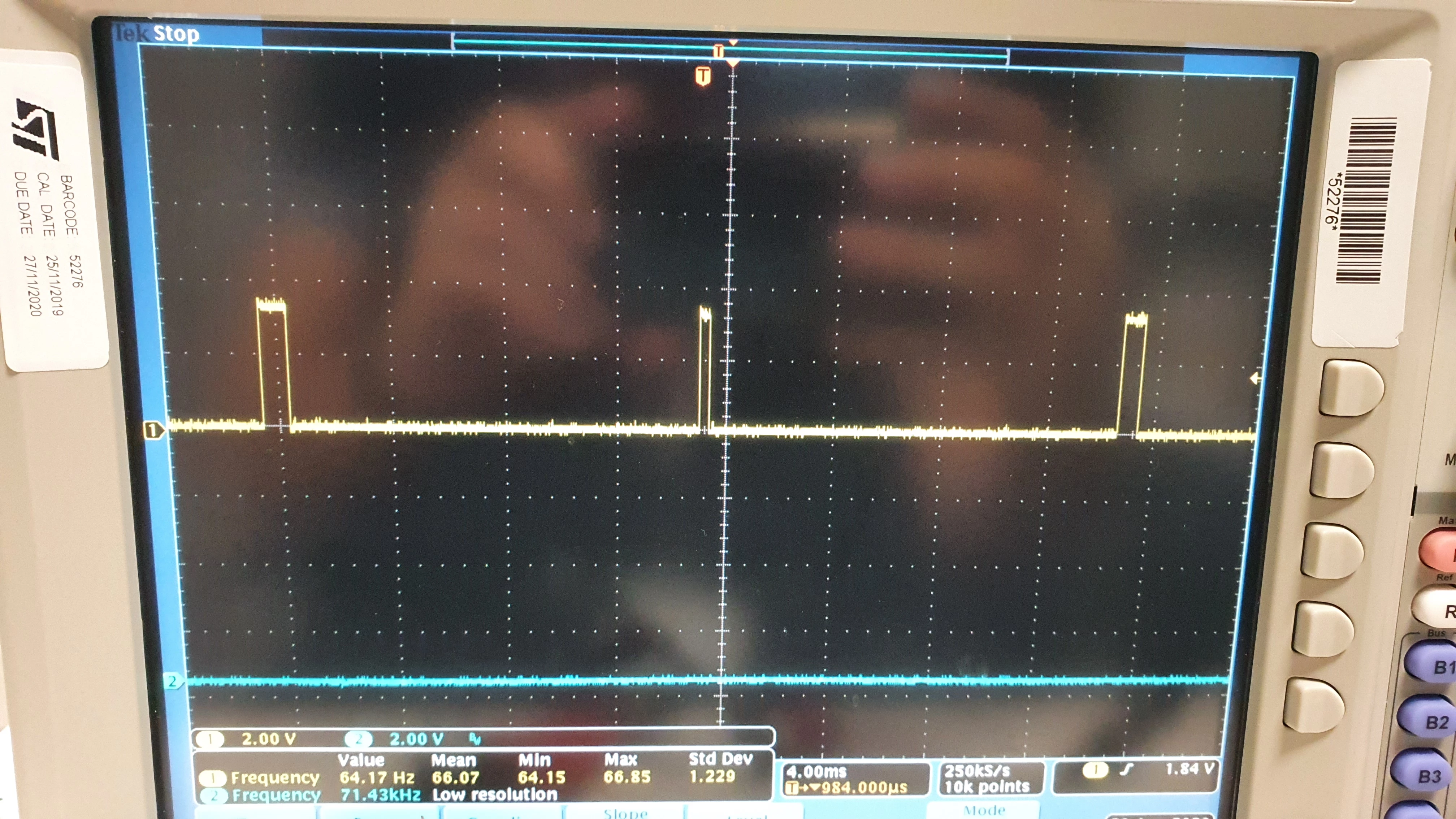

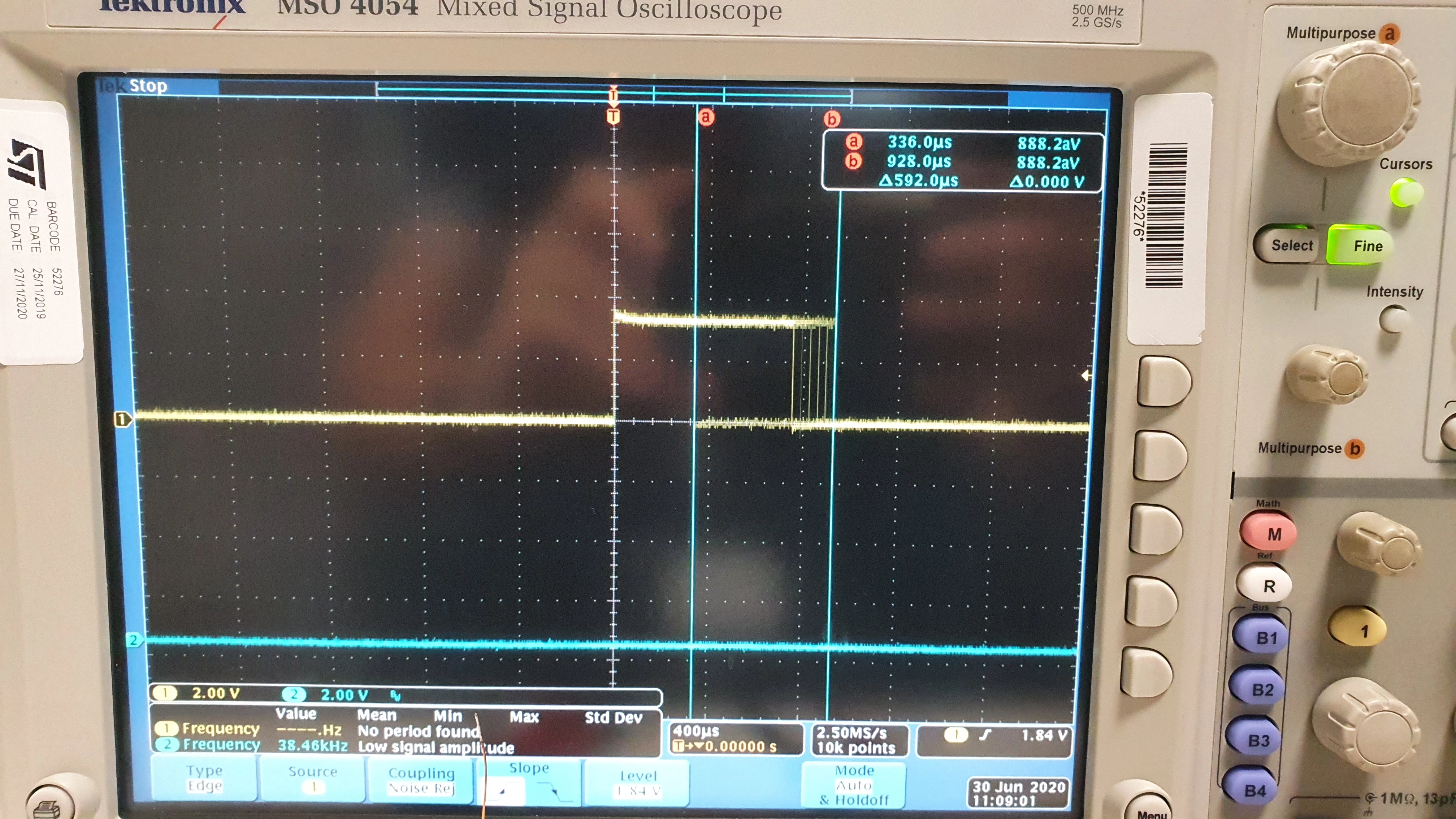

Hi @Loris Wyss​ , what I can see following this procedure is that I can see the interrupt on INT1 (instead of on INT2 as you reported.. I tried to trigger the shot on the INT2 signal but it is always at 0V, see the blue line), and this interrupt is flickering in DURATION of about the quantity you reported. This could cause the jitter. But the distance between the rising edge of two consecutive interrupt pulses seems the same (cursor measure of 15.60ms)...
Single shot screen:
Multiple shots screen:
Did you set the interrupt duration (for example in the INT_DUR (33h) or in the WAKE_UP_DUR (35h) registers?
Regards
Loris Wyss
June 30, 2020
Hi @Eleon BORLINI​
Thanks for your feedback, You're right I mixed up the interrupt pins in my instruction-post.
It's strange that you don't see the Jitter on the rising edges. I just tried it again and I can still see the exact same behaviour as described/shown in the first post.
Could you try zooming in at the rising edge, which follows the one you triggered on? If you let the measurement run, you should be able to see that the rising edge is jumping between two positions...

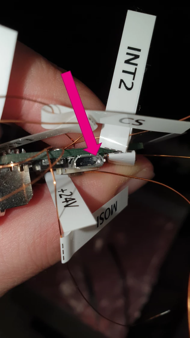

Hello @Loris Wyss​ , you are fully right and I'm here in lab to try to test the board, but the USB connector seems damaged (maybe due to the soldering of the GND wire), so I cannot plug the USB easily.
Since in these days I'm pretty alone in lab, what I can suggest you is to ask for support to the ST regional sales offices/representatives and FAE. I may send them your PCB, if you open your OLS request. Regards
Loris Wyss
June 12, 2020
Hello @Eleon BORLINI​
Thanks alot for your answer!
Well, the USB-Port isn't needed to put the Board in operation, it's only for Logging/Debug Purposes.
The PCB is powered through the GND/+24V-Pins.
