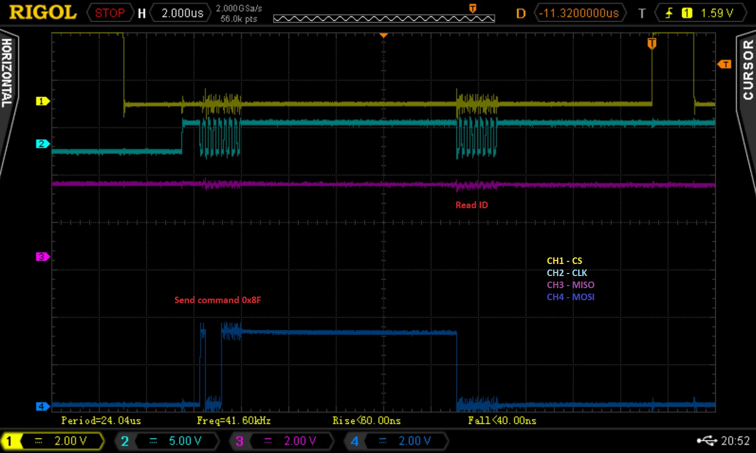

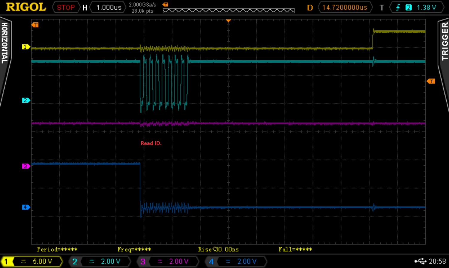

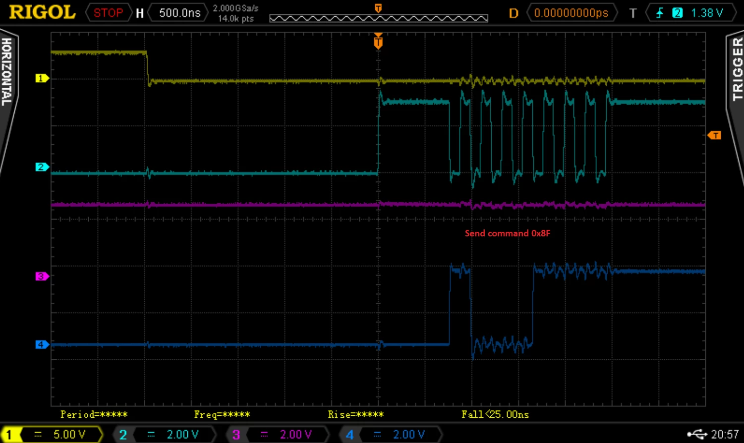

When the LIS2DW12 is asked for the first time for ID it does not response(responses with 0xFF).
The second time responses regularly with 0x44. Enclosed are SPI signals for the first try.
