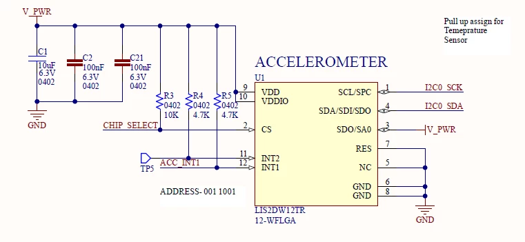

I am currently working on a development project where I'm utilizing the LIS2DW12 accelerometer. However, I've encountered an issue with the current consumption of the accelerometer on our custom board. I would appreciate your assistance in resolving this matter.
Configuration Used:
lis2dw12_block_data_update_set(&dev_ctx1, PROPERTY_ENABLE);
lis2dw12_full_scale_set(&dev_ctx1, LIS2DW12_8g);
lis2dw12_filter_path_set(&dev_ctx1, LIS2DW12_LPF_ON_OUT);
lis2dw12_filter_bandwidth_set(&dev_ctx1, LIS2DW12_ODR_DIV_4);
lis2dw12_power_mode_set(&dev_ctx1, LIS2DW12_HIGH_PERFORMANCE);
lis2dw12_data_rate_set(&dev_ctx1, LIS2DW12_XL_ODR_25Hz);
Issue:
After incorporating the LIS2DW12 accelerometer into our custom board, we noticed a current consumption of approximately 1.5 mA. However, upon removing the accelerometer, the current consumption dropped to 1.5 uA. We expected the accelerometer to be a low-power device, and this discrepancy in current consumption has raised concerns.

    First I suggest you to remove R4 and R5 since they are output push-pull.
    If you want to use them in open drain configuration please enable PP_OD in reg 22h.

    Hi @Vitthal Mali​ ,
    Welcome to ST Community!
    Can you please share your schematic?

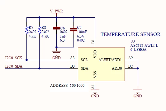

    We encountered a situation where the same SDA and SCL pins of our NRF52833 Microcontroller are connected to both an accelerometer and a temperature sensor. During our investigation, we discovered that the CS (Chip Select) pin of the LIS2DW12 accelerometer has an internal pull-up register. As a result, we removed the R3 register and connected 4.7k pull-up resistors to the SDA and SCL lines. CS Pin of LIS2DW12 is kept open.
    We would appreciate your support in confirming whether our approach is appropriate for this configuration. Specifically, we would like to know if connecting the pull-up resistors to the shared SDA and SCL lines is a suitable solution. Additionally, we would like to ensure that this setup will not cause any conflicts or issues with the communication between the NRF52833 microcontroller and the devices connected to the shared bus.
