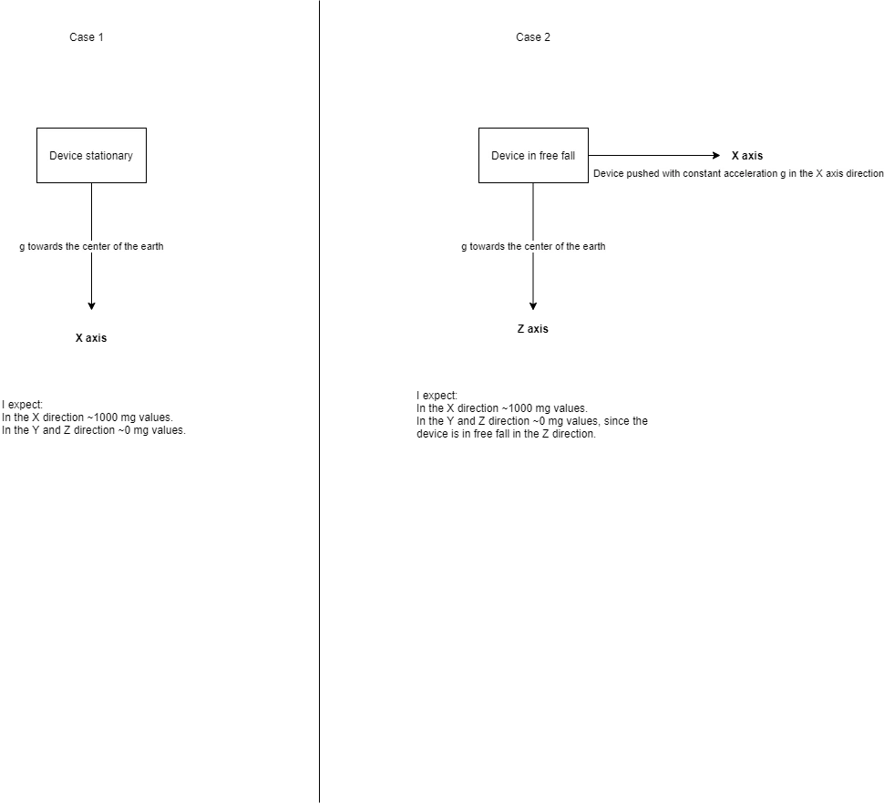

APipm.1
May 24, 2021 9:59 AM UTC
Hi!
There seem to be two scenarios between which we can't distinguish:
  1. A stationary device. Lets assume the X axis is facing towards the earth.
  2. A free falling device, with the Z axis facing towards the earth, and a constant force with acceleration g applied towards the X axis.
From what I gather, both scenarios will report the same measurements, a ~1000mg value read in the X direction, and a ~0mg value read in all other axis.
I've added an image showing these two scenarios, could you take a look and comment your thoughts please?

niccolò
May 25, 2021 9:51 AM UTC
Hi @APipm.1​  and @Msaga.1​ ,
the situation you describe is very peculiar and I'm afraid in that case (with only the data in that moment) you can't know which scenario is detected by the sensor, because the data should be the same.
anyway, you should be able to know which is the starting position of the device, so you can pinpoint the exact scenario
hope I could explain myself
