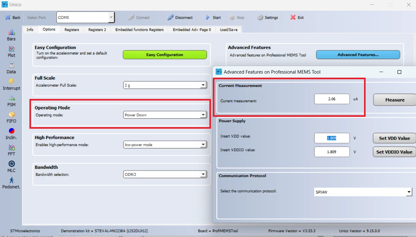

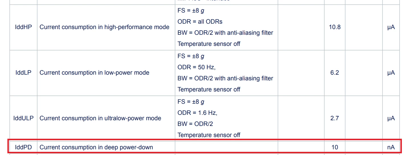

I'm evaluating the LIS2DUX12 accelerometer by using the combination of STEVAL-MKI109V3 and STEVAL-MKI238A. In the datasheet it stablishes that it can reach down to 10 nA during deep power-down:
But when I measure the current consumption through Unico-GUI, it says it consumes 2 uA which is similar to the consumption described as "ultralow-power mode" in the datasheet.
I would like to know if I'm missing something to modify in order to achieve the datasheet value or is it just that STEVAL-MKI109V3 is not capable to measure such low current.

You see 2uA because you are in SOFT power down and the 50nA reported in the DS are in DEEP power down.
At page 17 in datasheet is described how to switch between soft and deep.

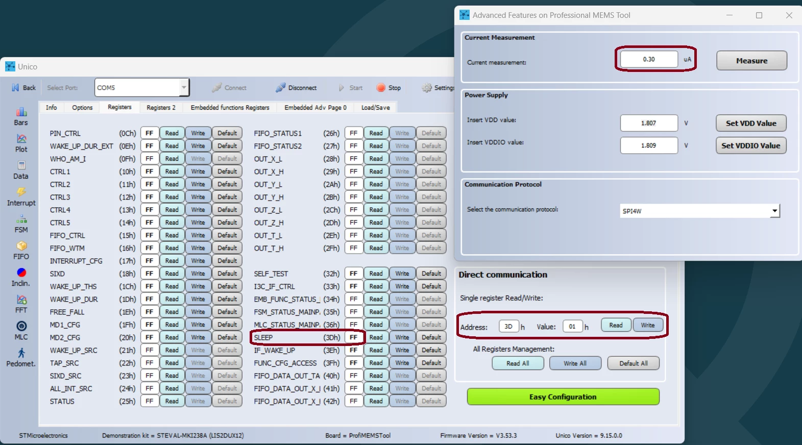

Hello @Federica Bossi
Thanks for you reply, I applied the value to the 0x3D register as specified in the datasheet and pointed by you and I see an improvement in the power consumption but still 30 times above the expected value:

Thanks for the heads up @Federica Bossi! So is it in theory being reduced down to ~2 nA when I set the 0x3D register and just not being reported correctly by the STEVAL-MKI109V3?
Federica Bossi
October 23, 2023
Exactly, it is a problem of Unico fw but with the new release you will see a current consumption in deep powerdown of about 20nA.
