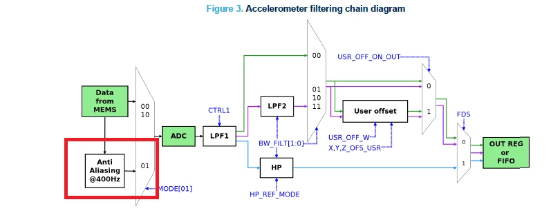

I'm using an LIS2DTW12 and I don't understand very well which is the cut off frequency.
I'm quite confused because from this picture seems that the anti aliasing filter has cut off frequency fixed to 400 Hz :

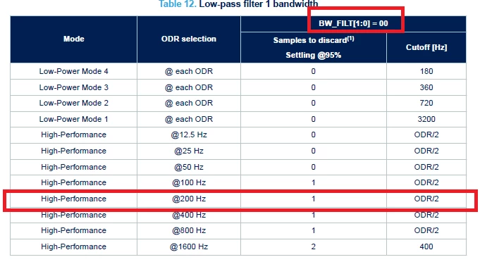

Then in this table the cut off frequency after the LPF1 and LPF2 seems ODR/2:
0693W00000NrRQ9QAN.pngI'm interested in the 0-100Hz part of the acceleration so my ODR is 200 Hz.
I want know if the part of the acceleration above 100Hz is cut off or if only the part above 400Hz is cut and then there will be aliasing.

    Hi Riccardo @RStra​ ,
    To answer your question:
    Frequencies above 100Hz will be cut from Nyquist theorem. Since the out-of-band power will be in any case not equal to zero, there will be the possibility of some alias effect coming from strong tones above 100Hz, especially in the 100Hz-400Hz band.
    -Eleon

    thank you for your response, so the anti aliasing filter has a cut off frequency of 400Hz. To reduce the aliasing should I increase the ODR to 800Hz or 1600Hz ?
    Eleon BORLINI
    Jun 10, 2022 1:22 PM UTC
    Hi @RStra​ ,
    yes, it can be a solution.
    -Eleon
