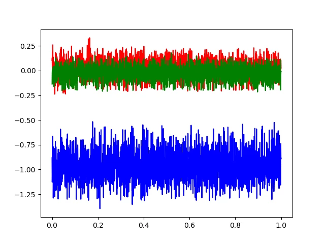

I have a LIS2DS12 accelerometer connected to an arduino MKR1000 through SPI.
For my application I need to use the highest ODR of 6400 Hz, and 2g FS.
In order to collect 1 s of acceleration data, I constantly pull data from the FIFO. I set the threshold to 5, and FIFO in continuous mode.
In the attached plot, you see X, Y and Z acceleration data with LIS2DS12 standing still on my table, with a very high noise!

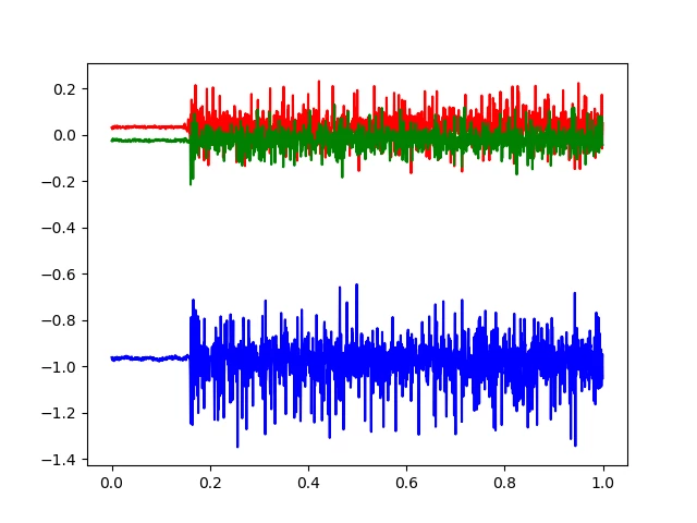

In order to understand the origin of such a high noise, I first get a full FIFO and then I start to pull out data through SPI.
In such a way you can see that first 256 values have a certain noise, while as soon as I start SPI communication the noise increases.
Is this a knows issue?
Thanks a lot.

    Hi @Avian.1​ , so you are basically filling the FIFO up to 5 samples (at ODR 6400Hz, threshold = 5), and then you read the FIFO content via SPI, right?
    If you set a threshold, you should work in pure FIFO mode, i.e. stops collecting data when FIFO is full. As noted in the AN4748 p 43:
    Follow these steps for FIFO Continuous configuration which sets a threshold to generate an interrupt to trigger a read by the application processor:
    1. Set FTH[7:0] to 255.
    2. Set INT2_FTH to ‘1’: Enable FIFO threshold interrupt
    3. Activate Continuous mode by setting the FMODE[2:0] field to 110b in the FIFO_CTRL register (25h).

    I'm sorry to tell you that I've tried a lot changing fifo mode, setting interrupts, and so but noise was always there.
    At the end, I gave up and changed accelerometer (IIS3DWB).
    I just think that LIS2DS12 is not made to work at high ODR.
