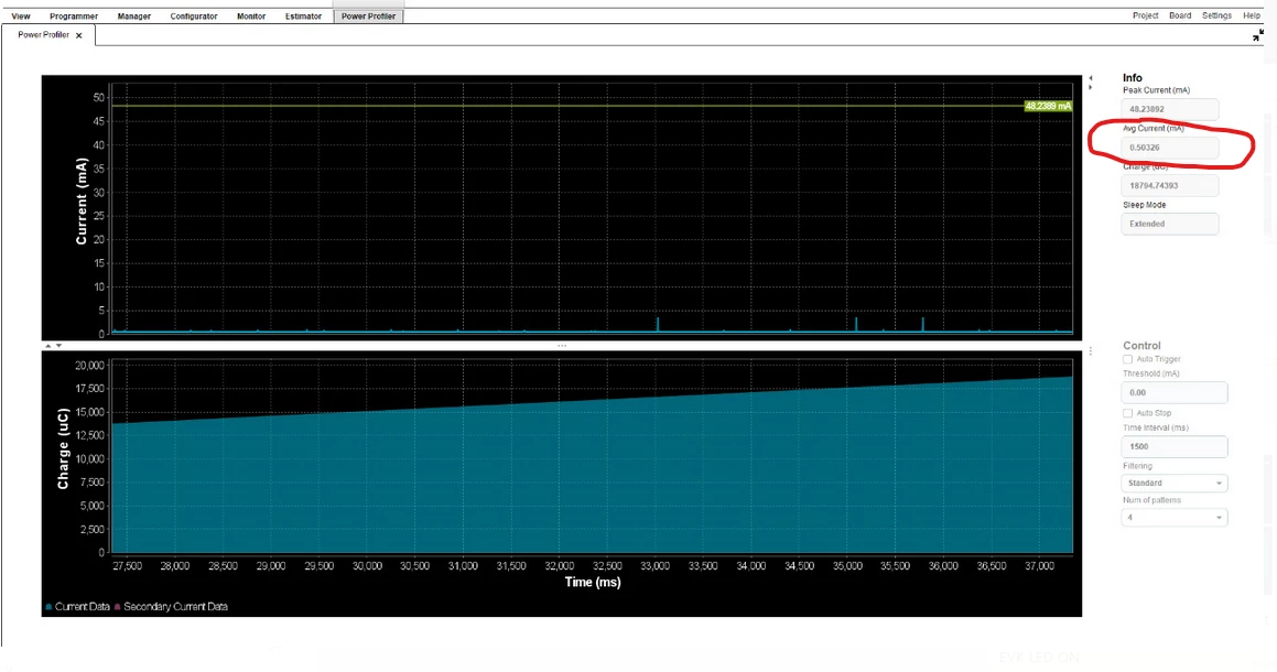

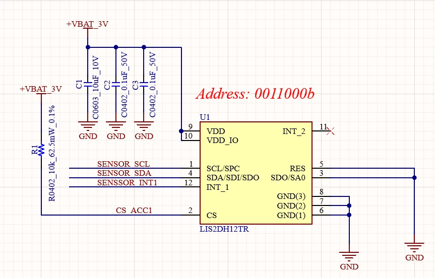

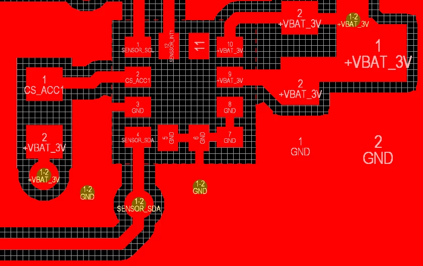

LIS2DH12TR Power consumption is 500uA. I have attached the Schematic and PCB file. Could you possible to suggest the power reduction in hardware or firmware level.

How much current is consumed by this section of the board if you remove the LIS2DH from it?

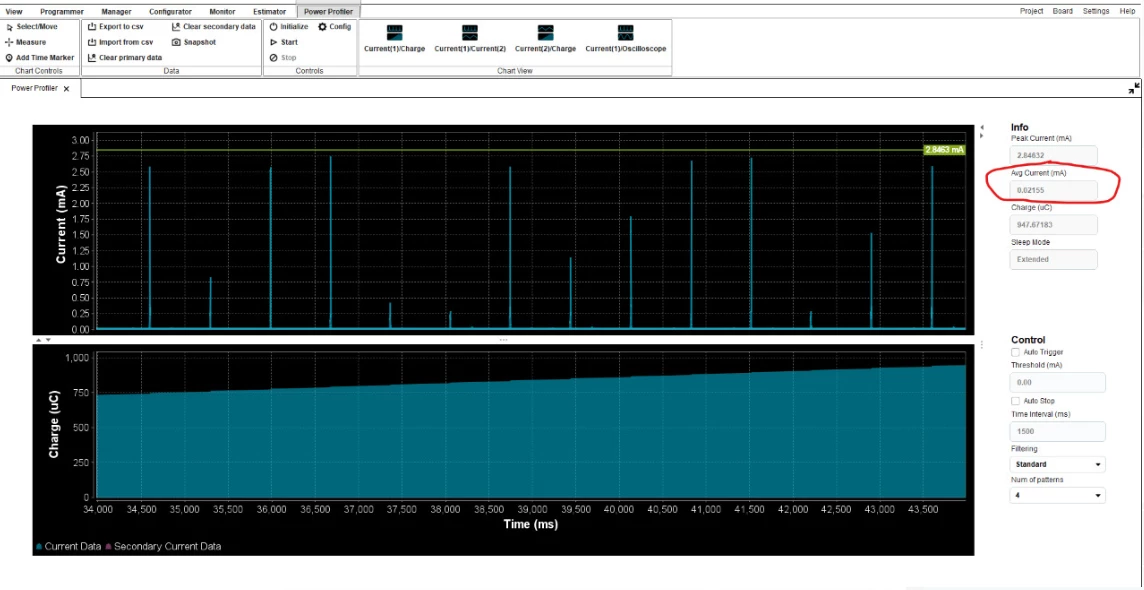

Without accelerometer the board consuming 17uA. With Accelerometer 504uA. Above picture I mentioned the current consumption details

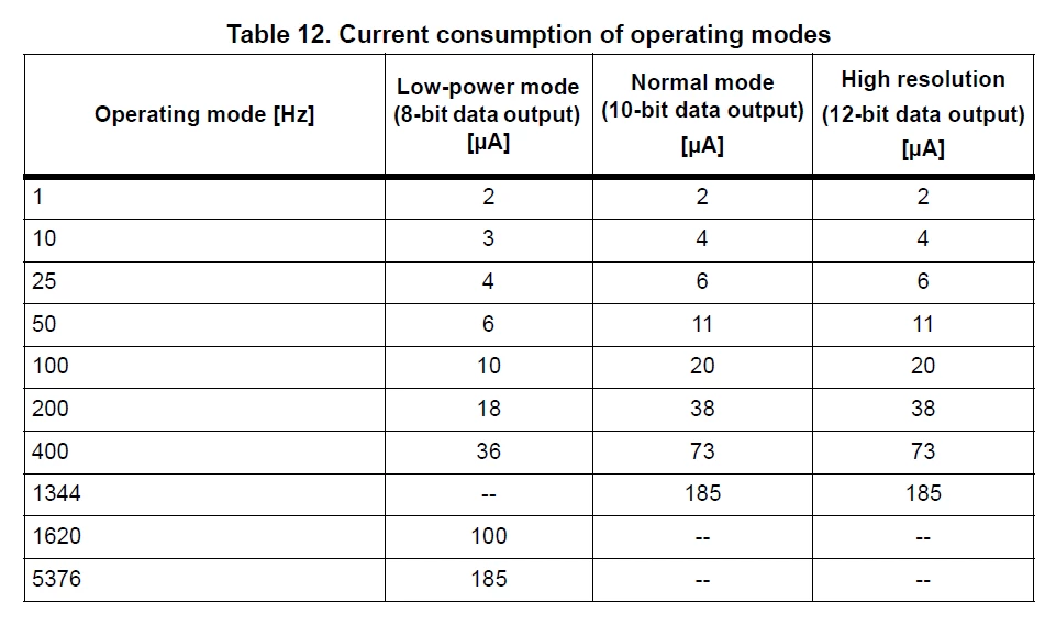

0693W00000QNu4EQAT.pngI have similar chip and it draws 5uA.
You need to disable high resolution mode, and use low frequency update, like 100Hz or even less.
Can you read WHO_AM_I register ?
