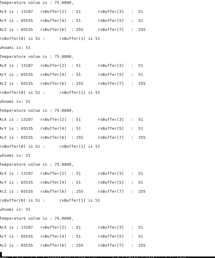

Hi ,
I'm trying to read the accelerometer data from the LIS2DH12TR which is connected to CC1310 TI's Controller.
In my design I'm using I2C hence i have connected the CS pin to Vdd(3.3V) and SA0 pin to VDD. As per the Data sheet with my case the address will be 0x19(SA0 is connected to Vdd).
I'm able to initialize the I2C and while reading the Data it always prints all values to zero except the Out_Z(H & L) and Out_H and Out_L are 255(Out_Z= accelerometer values in the z direction).
What could be the reason for this?
I assume it's factory calibrated.
Here's the attached code with CC1310(CCS):

    ​Hi, to check the I2C communication did you try a single read of the WHO_AM_I (0Fh) reg? You should get 33h value. Consider that the factory calibration are stored in the reserved registers 00h-06h and could be 00h. Another point is if you are using the I2C multi-read sequence according to ds specs? Its very strange you see only one axis well (maybe only MSByte)... Better if it is possible for you to share the oscilloscope screenshots. Regards.
    LN_it
    LN_itAuthor
    May 22, 2019
    Hi, Thanks for your quick reply. I tried reading the OFh Register But as you can see it's returning 51(integer).
    Since I don't have an oscilloscope, I'll check and share you the screenshots shortly. 0690X000008wFDbQAM.png

    Eleon BORLINI
    May 27, 2019
    Did you correctly initialize the reg CTRL_REG1 (20h) in terms of ODR value? Lçet me pls know if you succeed in correctly reading the data. Regards
    LN_it
    LN_itAuthor
    May 28, 2019
    Yea I have set CTRL_REG1(20h) to 57h i.e. 0101 (100Hz ODR) but still Accel x,y,z, values never changes.
