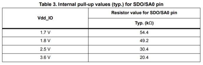

Hello, everyone,
we found that the working current is too high during the use of the LIS2DH12 sensor. The current is as high as 290ua. According to the specification, the high resolution of 100Hz is 20ua. The working current is much higher. I don’t know if there is a problem with the configuration. The following is my code , I also tried to configure to play in low-power mode, but the current is not numbered.

Hi @党军 �?�​ ,
Let me please better understand the point.
Are you using the I2C protocol for the communication right?
How did you set the SDO/SA0 pin at hardware / firmware level?
Please note that this is pin has Internal pull-up, and if you are connecting it to the GND layer you have to take into account of the consumption coming from the pullup resisters (see datasheet, p.9):
0693W00000DnNXDQA3.pngOr otherwise, you should tie the SDA/SA0 pin to Vdd or disconnect it.

Useing the I2C communication,
The SDO/SA0 pin on the hardware is disconnected
Eleon BORLINI
September 20, 2021
Try with pulling SDO/SA0 up to Vdd, and then check the consumption.

I tried it and the result was the same.
At present, it is found that the interrupt signal does not match. After we set the MCU interrupt pin to the first level, the current is about 114uA. Including the working current of the MCU.
