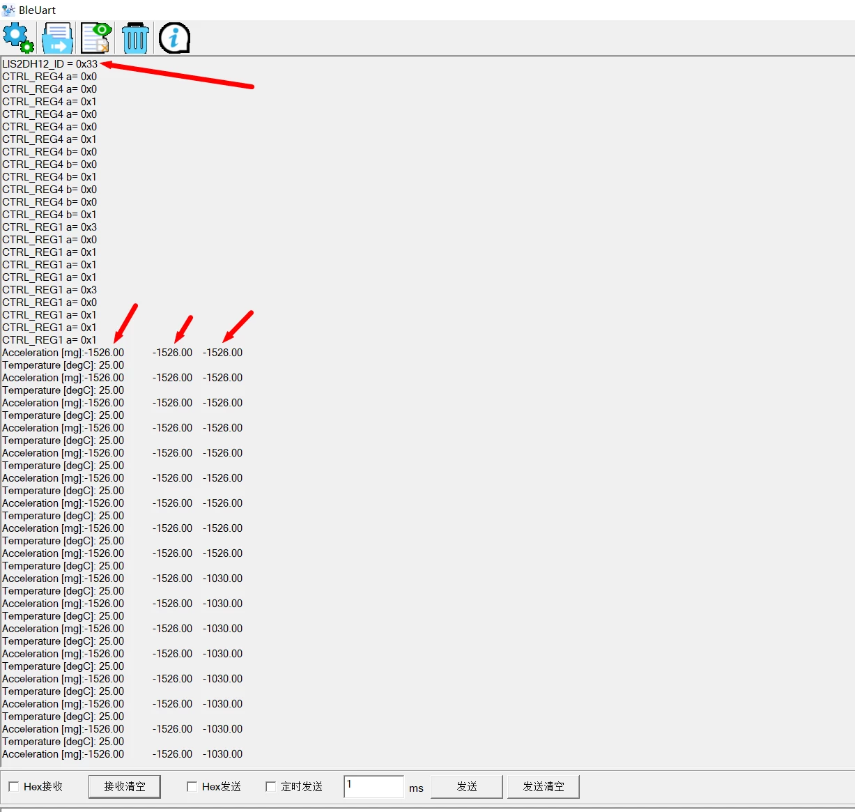

LIS2DH12 SPI Read ,The returned data is unchanged; lis2dh12_device_id_get(&dev_ctx, &whoamI) is right, whoamI=0x33

    Why hasn't the acceleration_mg changed?

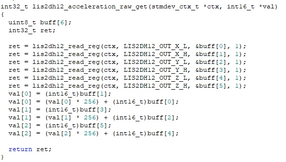

    I tried to debug this problem and found a simple solution, which is to manually increment the address by myself, as shown in the picture. Or use a driver that automatically increments the address.
    Visitor II
    September 16, 2023
    Another solution is to enable register address auto-incrementation. It is enabled by adding value 0x80 to the register address. For example: i2cread(DEVICE_ADDRESS, OUT_X_L | 0x80, buffer, 6); to read 6 register bytes in one go,  starting at address 0x28 (which is OUT_X_L).
