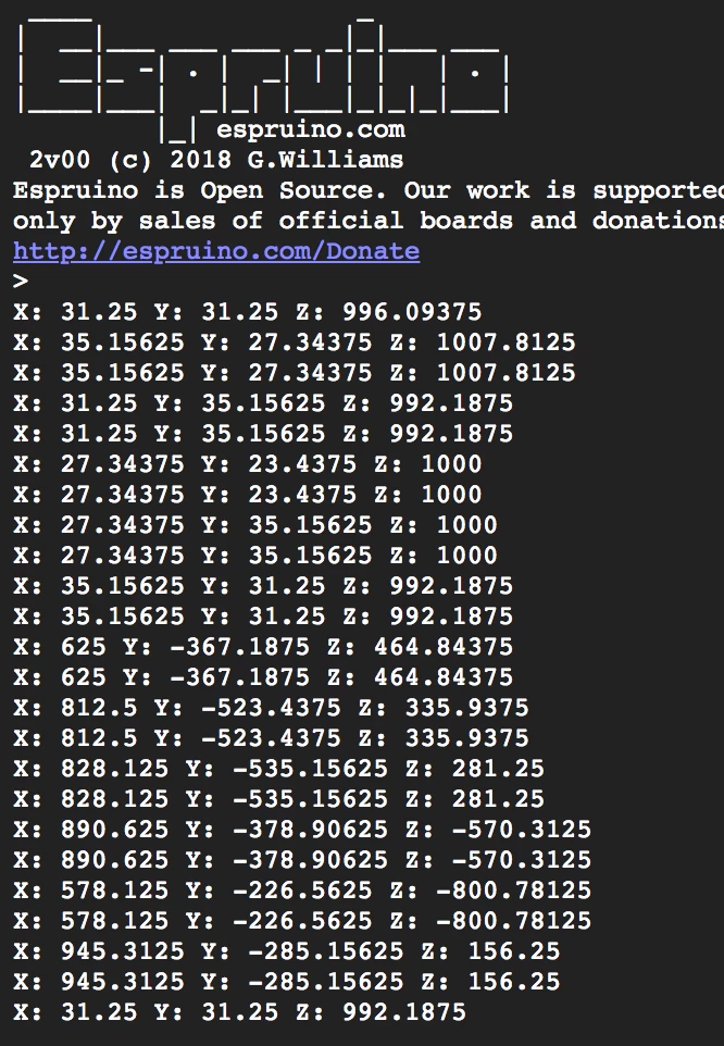

Hello there,
I have a device called RuuviTag that includes your LIS2DH12 accelerometer and that can be programmed by means of an IDE called Espruino in JavaScript.
For a project, I am trying to get the tilt angle of the device measured in degrees with a value between 0 and 360. At the moment, however, I'm not succeeding and looking on the internet I found this documentation:
https://www.st.com/content/ccc/resource/technical/document/application_note/d2/d6/22/4f/b9/8f/45/59/DM00119046.pdf/files/DM00119046.pdf/jcr:content/translations/en.DM00119046.pdf
Do you have any code to which I can get information for this problem? I tried to use equation 2 but it doesn't give me back the angle. I also tried equation 6 but it doesn't work.
The values I can take from the accelerometer are values in mg.
Here is the photo:
Do you know how to help me?
Thanks.

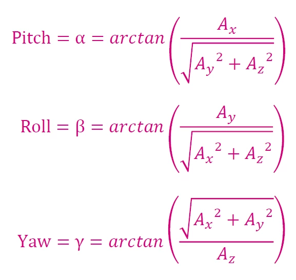

Miroslav BATEKBest answer
Oct 29, 2018 12:54 PM UTC
These formulas works for range -90° to +90° in all three angles:
For Pitch you can use other formula for range -180° to + 180°:
Pitch = arctan2 (Y/Z)
6 replies

Oct 29, 2018 1:21 PM UTC
Hi Miroslav, thank you very much.. It seems to be working properly!
In order to make that I used:
pitch = (((Math.atan2(accelerationY,accelerationZ) * 180) / 3.14 ) + 180 );
By using the AccelerationY and accelerationZ provided by the device, than converted in degree and "+180" offset to get values from 0 to 360.
