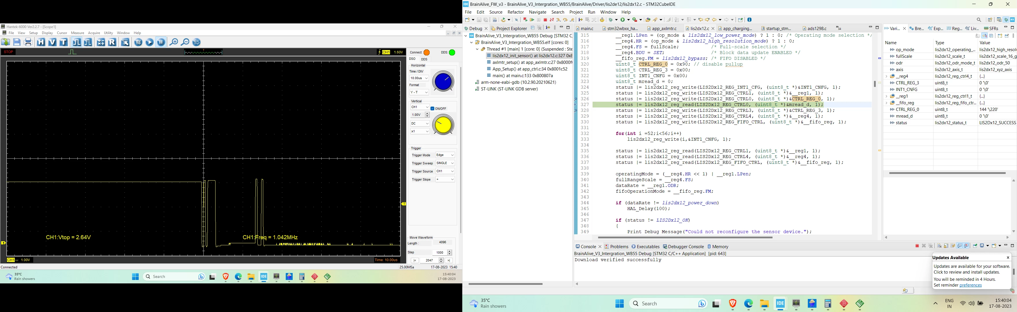

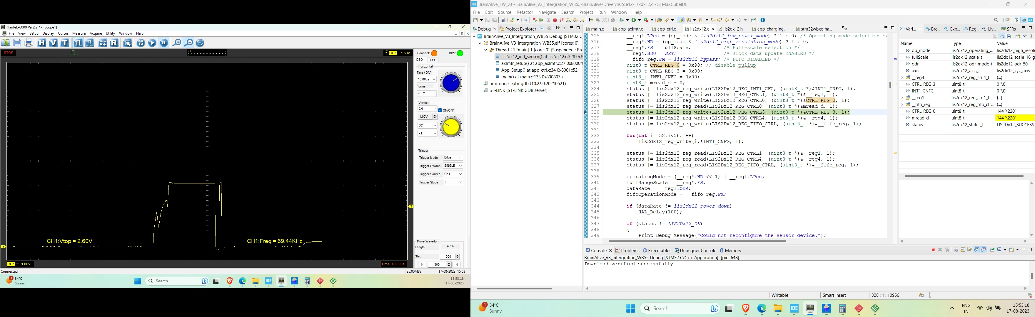

And I also follow the specifications on page 30. I am using the SPI CLK at 2 MHz. Is there any lower limit of clock frequency because, in the datasheet, the max limit is defined that is 10MHz?
I am also getting some issues in writing the register as you can see in the screenshot of the scope.
In this screenshot i am writing some value in the register. and in the left side you can see the scope this is the MOSI pinIn this screenshot i am writing some value in the register. and in the left side you can see the scope this is the MOSI pinThis is the status of MISO pin. In this screenshot i am reading the register which i have written but i am getting different value on readingThis is the status of MISO pin. In this screenshot i am reading the register which i have written but i am getting different value on reading

Hi @Smalik ,
I remember you :) Those SPI patterns are not so good... is your setup working at any Vdd/VddIO? I suspect there is some issue in the SPI communication (2MHz clk is OK), probably not related to the Vdd level itself.
Last year you shared this picture:
Here it looks you are working in SPI mode 1 (CPOL=0, CPHA=1), but the device works in SPI mode 3 (CPOL=1, CPHA=1), with the clock polarity in idle state at Vdd and the CS line that must switch from high to low state just before stating the clock toggling (16 clock pulses).
