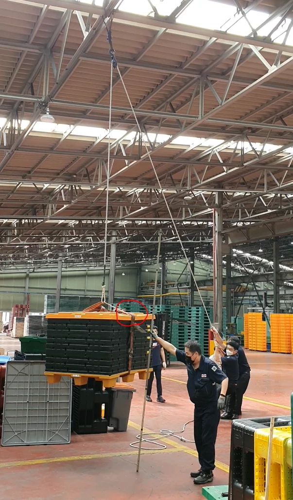

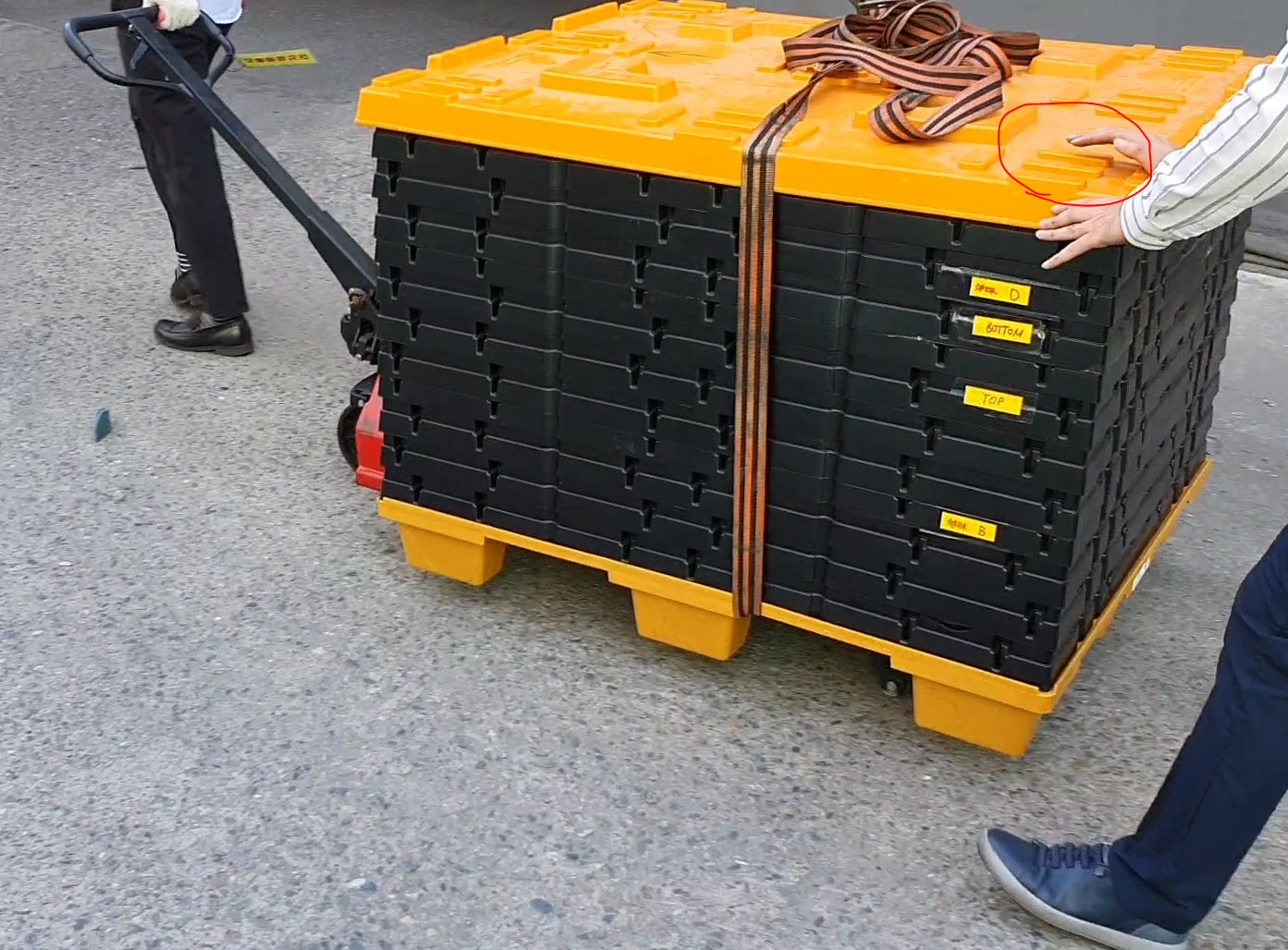

SChun.5
SChun.5Author
Jul 21, 2021 12:42 AM UTC
0693W00000D0AUhQAN.png0693W00000D0AUmQAN.pngThank you for your reply.
I've two more questions about our test case.
  1. we got X = 14496 , Y = 19568 , Z = -30944 and X = -22576 , Y = 9136 , Z = 32640 values in different timestamp, Is it possible to get those values in the round-back trip test?
  2. we tested on our lab in a different condition, we got more impact on our sensor from bumpy road test than free-fall test. the test conditions are attached. Do we usually receive more impact on the bumpy road than free-fall?
Thank you for your support.
TBomb.1
TBomb.1Best answer
Visitor II
Jul 22, 2021 7:46 AM UTC
Yes it is possible to get higher acceleration values from a shock impact than in case of free fall, it depends on the intensity of the pulse. You have to choose the correct full scale to be able to detect these shocks, for example the 16g FS.
The values X = 14496 , Y = 19568 , Z = -30944 and X = -22576 , Y = 9136 , Z = 32640 are above 2g: are you using higher full scales?
Tom
