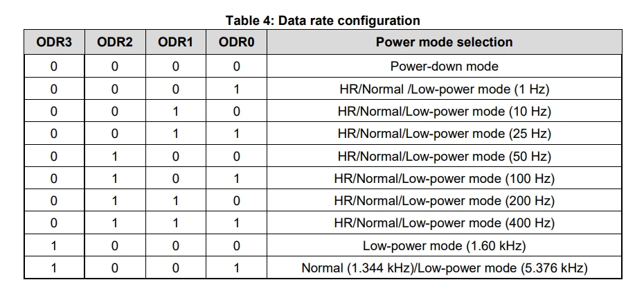

LIS2DH12 accelerometer. Datasheet AN5005 shows Table 4.
Is this the speed of data transfer via the SPI or I2C interface? Or the speed of converting data into accelerations and writing this accelerations to the OUTX_H and OUTX_L registers?

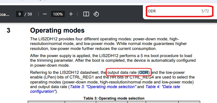

The Datasheet never once gives the meaning of the "ODR" abbreviation.
The Application Note uses it four times before finally mentioning the meaning on page 9 - and that's just in passing:
Even that's not very clear: it could be bits per second, bytes per second, etc, ...
That's an Application Note - not the Datasheet.
The Datasheet is https://www.st.com/resource/en/datasheet/lis2dh12.pdf

Hi @Andrew Neil ,
As in the screenshot posted by @MykolaLevun the unit of the ODR is Hz.

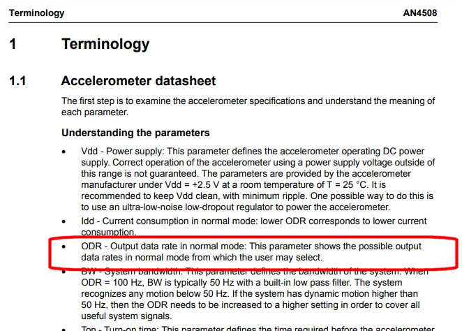

There's also Application Note AN4508, "Parameters and calibration of a low-g 3-axis accelerometer"
It has a 'Terminology' section, but still doesn't make it clear:
