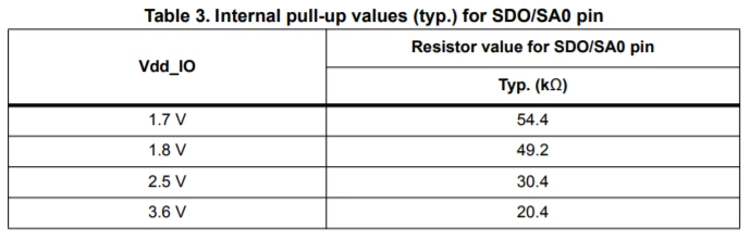

Hello folks,
I am trying to interface LIS2DH12 with NRF52840 DK(nordic semiconductor's Development Board )by using SPI bus protocol for which I have used the ST drivers from the link below,
https://github.com/STMicroelectronics/STMems_Standard_C_drivers
and used example "lis2dh12_read_data_polling.c"
and configured the example with the below settings,
ODR = 10Hz (even tried with 1Hz)
LOW POWER MODE (8-bit mode)
FULL SCALE - 2g
TEMPERATURE SENSOR - DISABLE
I am getting around 137-140 uA which is way more than the mentioned value in the Datasheet(around 2uA - 3uA).
And for testing, I even tried with the I2C bus protocol but still got a 140 uA+ reading.
So, any suggestions where I might be going wrong.

    Hi @ASing.15​ ,
    It might be related to the SDO/SA0 pin at hardware / firmware level?
    Please note in fact that this pin has an internal pull-up, and if you are connecting it to the GND (for example, when your device is in idle state) you will experience the consumption coming from the pull-up resisters (see datasheet, p.9):
    0693W00000DnNXDQA3.pngCan you please try to leave it at Vdd when the SPI is not running?
    -Eleon
