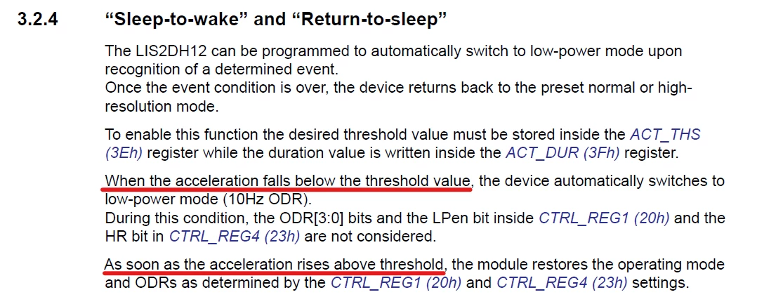

According to datasheet and AN5005, LIS2DH12 accelerometer can go to sleep & wake up + generate I2_ACT interrupt when acceleration goes below / above the threshold defined in ACT_THS.
Which acceleration exactly is taken into account for this strategy? Maximum / minimum of X,Y,Z? Resultant? Is gravity compensated for or not?

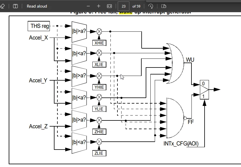

    Hi @Community member​ ,
    This functionality also works the same way. The three axis are in OR so if one axis is above the threshold you have the switch.

    As you can see in fig 8 of AN5005, when you use wake up if one axis is above the defined threshold you have the I2_ACT interrupt.

    If I got it right, figure 8 applies to the free-fall and wake-up configuration of INTx interrupt that is set up by writing to INTx_CFG, INTx_THS and INTx_DURATION registers.
    My question was about another functionality that is configured by writing to ACT_THS (0x3Eh) and ACT_DUR (0x3Fh) registers:
    Which acceleration is considered above, underlined in red? There is no such register for this functionality, as there are INT1_CFG and INT2_CFG for free-fall and wake up-interrupts, which allow the AND / OR combination of some / all axes to be specified. So how are the 3 axes combined together here to make the device switch between "Sleep-to-wake" and "Return-to-sleep"?
    This was the information I was missing. Thank you.
