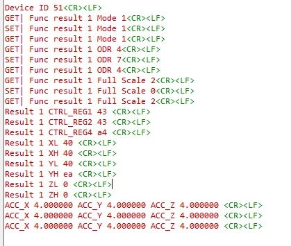

I am using LIS2DH12 with SPI connection.
I am able to read back Device ID which is 51. Also, I can write a to the reference register and read back successfully.
However, I cannot set registers. I am writing value on it and read back. The value on the register does not change.

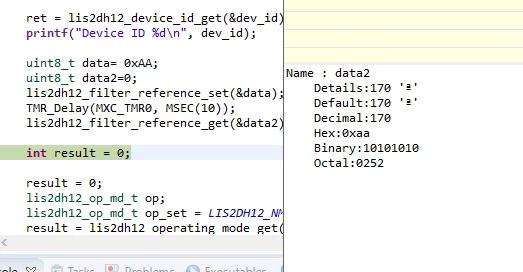

uint8_t dev_id;
 ret = lis2dh12_device_id_get(&dev_id);
 printf("Device ID %d\n", dev_id);
 uint8_t data= 0xAA;
 uint8_t data2=0;
 lis2dh12_filter_reference_set(&data);
 TMR_Delay(MXC_TMR0, MSEC(10));
 lis2dh12_filter_reference_get(&data2);

 uint8_t buff[6] = {0};
 int16_t acc_x, acc_y, acc_z;
 uint8_t new_data;
 uint8_t reg_val;
 result = lis2dh12_read_reg_st(0x20, &reg_val);
 printf("Result %d CTRL_REG1 %x \n", result, reg_val);
 result = lis2dh12_read_reg_st(0x21, &reg_val);
 printf("Result %d CTRL_REG2 %x \n", result, reg_val);
 result = lis2dh12_read_reg_st(0x23, &reg_val);
 printf("Result %d CTRL_REG4 %x \n", result, reg_val);
 result = lis2dh12_read_reg_st(0x28, &reg_val);
 printf("Result %d XL %x \n", result, reg_val);
 result = lis2dh12_read_reg_st(0x29, &reg_val);
 printf("Result %d XH %x \n", result, reg_val);
 result = lis2dh12_read_reg_st(0x2A, &reg_val);
 printf("Result %d YL %x \n", result, reg_val);
 result = lis2dh12_read_reg_st(0x2B, &reg_val);
 printf("Result %d YH %x \n", result, reg_val);
 result = lis2dh12_read_reg_st(0x2C, &reg_val);
 printf("Result %d ZL %x \n", result, reg_val);
 result = lis2dh12_read_reg_st(0x2D, &reg_val);
 printf("Result %d ZH %x \n", result, reg_val);
The output of the program is like
I am running SPI with the following configurations;
1MHz Clock speed,
SPI Clock polarity active low, Sampling rising edge.
Could you help please to figure out my problem ?
 Also , why I am receiving same ACC value ?
Best regards

Hi @ESims.2​ , can you please explain me the initial part of your code, for my better understanding?
uint8_t data= 0xAA;
uint8_t data2=0;
Which LIS2DH12 register are you reading?
