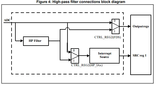

1- The bits HPCF2 - HPCF1 in the CTRL_REG2 (21h) corresponding to the high pass filter cut off frequency selection do not have any details mentioned about how they affect the cut-off frequency.

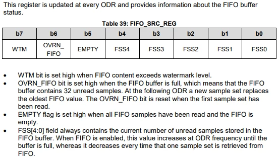

3- Also, there is no information about the various bits of the FIFO_SRC_REG (2Fh).
It would be really appreciable if you could share details on the functionality of these bits/registers.
This datasheet section is effectively not well detailed. However, you can refer to the application note AN3308 for the LIS3DH, which is quite identical to the from this register point of view. The High-pass filter working mode is described in p.17, p.18 and p.19 of this app note.
FIFO_SRC_REG (2Fh) register is described in the same application note, at p.44 and p.45.
