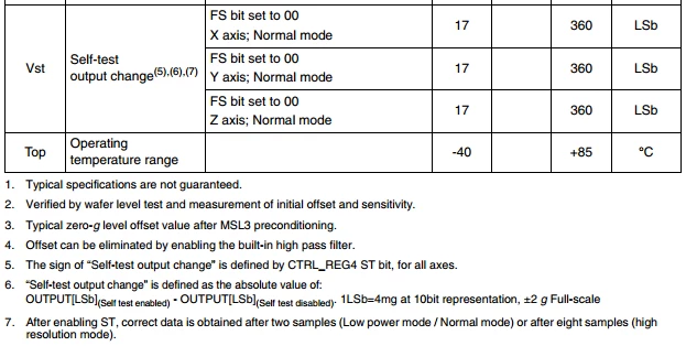

is it possible to know the minimum delay required to wait between register writing during the self-test?

If I don't put those delay of 7ms, the accelerometer will give me back wrong datas, like 0xff or datas from before the self-test was deactivated.
Thus, is there a minimum delay I need to set after I change my frequency or set other registers?

Recommended delay after the self-test is enabled is 200ms.
You should also discard 2 or 8 samples according to selected mode (see note 7 below)

And when I change the HPF mode and frequency? Do I need to put a minimum delay here too? Because I noticed that if I don't delay of a minimum of 7 ms  when I change those, I get strange readings.

ST rep sent a confidential doc specific to the selftest of the LIS2DH that calls for a minimum 11mS or ( 1/ODR + 1mS ).
The calculated time may be better depending on what ODR frequency you set but I found
( 1/ODR + 2mS ) is safer
I should note the doc I got from Terry at FirstAlliance(ST support rep) shows a different flow chart than the public PDF
I asked Terry and you can contact him for the doc but i asked and was told not to post it in the public sector
