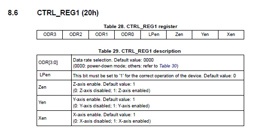

    According to the datasheet the ''LPEN'' must be set to 1.
    You should write 0x5F in the REG1, as I understand it.
    I hope it will help you, but as it's not working for me I doubt.

    Matt Wolfe
    Visitor II
    October 12, 2017
    Posted on October 12, 2017 at 15:52
    Thank you for pointing that out.  I gave it a try, but unfortunately it did not make a difference.  Please post back if you get it working and I will do the same.
