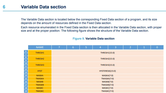

There is a device, which however is obsolete, that allows you to set 3 thresholds on 4 bits: LIS331DL, but I think this could be not the right choice for the future.
​There is a better way you could set 3 threshold and 3 masks for the desired axis / direction: you can use the finite state machine embedded e.g. on LSM6DSO / OX:
