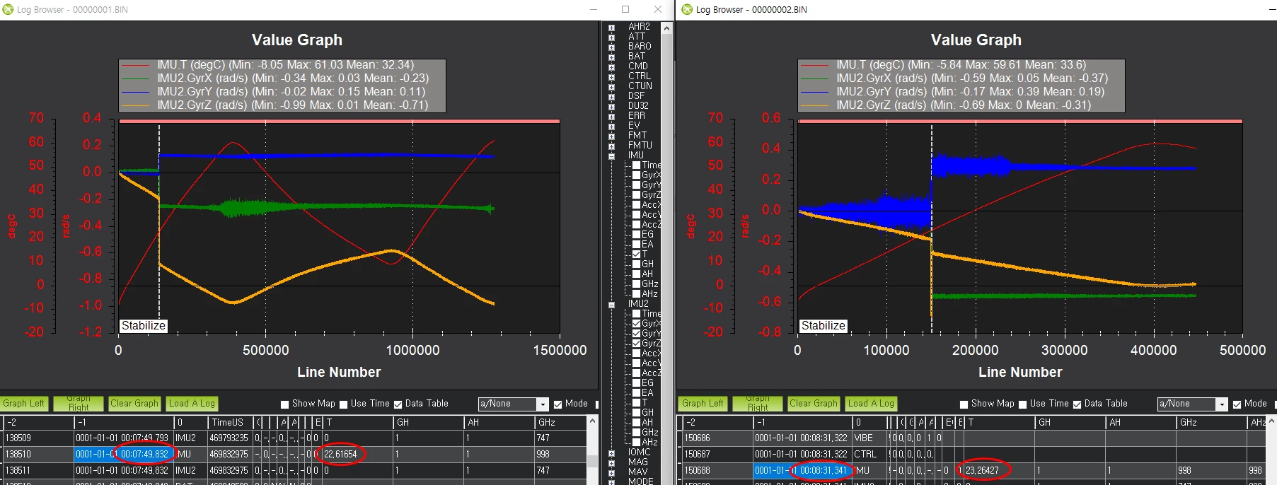

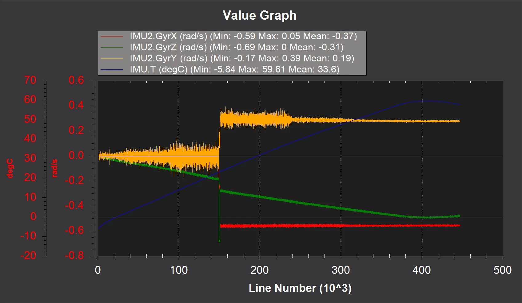

I'm using L3GD20H on a flight controller board for drones.
While conducting a temperature test that starts from -11°C and ends at 50°C, I observed a sharp rise/drop in gyro values at around 23°C. (The board stayed still the whole time inside a vibrating chamber.)
Can you give me any insight on why this happens or/and how to prevent it?

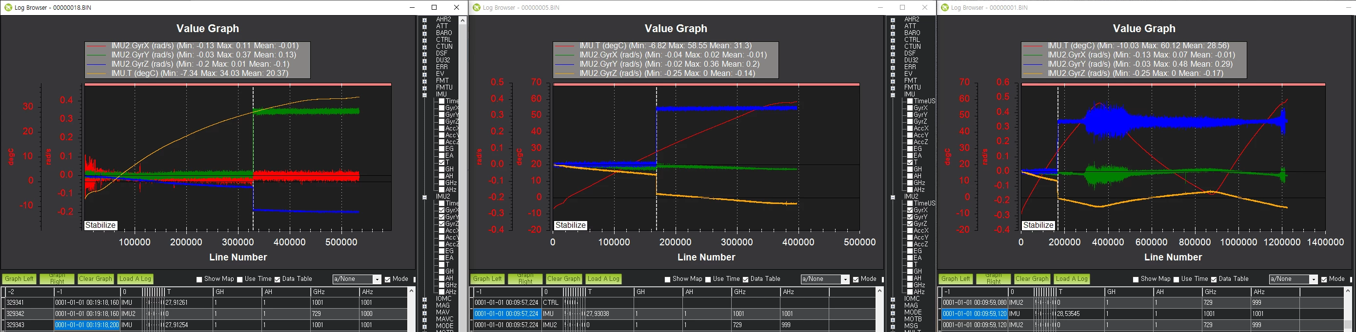

    Hi @Eleon BORLINI​ ,
    I double-checked and only 2 of my flight controller boards had the same issue.
    Also, it turned out that one of them was a fake chip posted on: https://community.st.com/s/question/0D53W00000cyCTnSAM/l3gd20h-fake-ic-issue
    Anyway, ​I ran another test with the genuine chip in an environment with a different rate in temperature change (picture on the left),
    And it also happened at 23°C.
    (The picture on the right is the result from my original post.)
    0693W000008wzCGQAY.png​

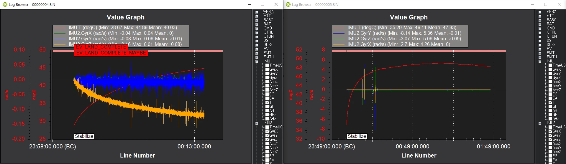

    Also, I checked if this is a time-related issue. I left the board on for about 14 mins (left) and 2 hours (right) at room temperature and both didn't have the problem.
    0693W000008wzMBQAY.png​
