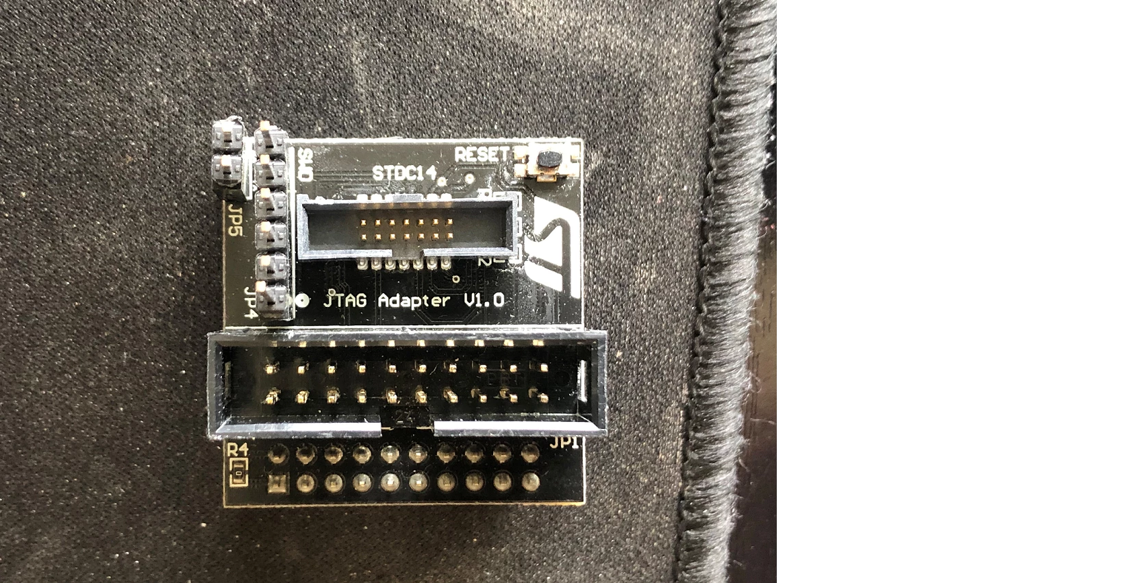

Kindly provide the schematic for this board

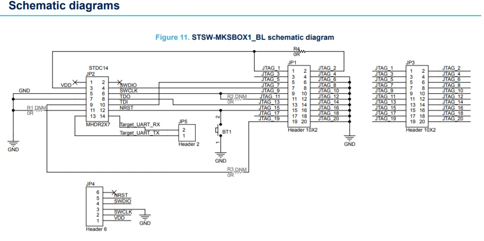

    Hi @Snara.2​ ,
    You can find the schematic of this JTAG adapter in this document, p.13, the Data brief of the STSW-MKSBOX1_BL.
