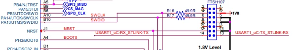

we recently got the SensorTile.box  which is a great toy. However we want to write our own applications and use the STDC14 debug connector. I just rread that only ST-LINK/V2 will be supported due to 1.8V debug interface.
Where can I get an adapter form Jtag-20 to STDC14 or 10-pin Cortex-M to STDC14.

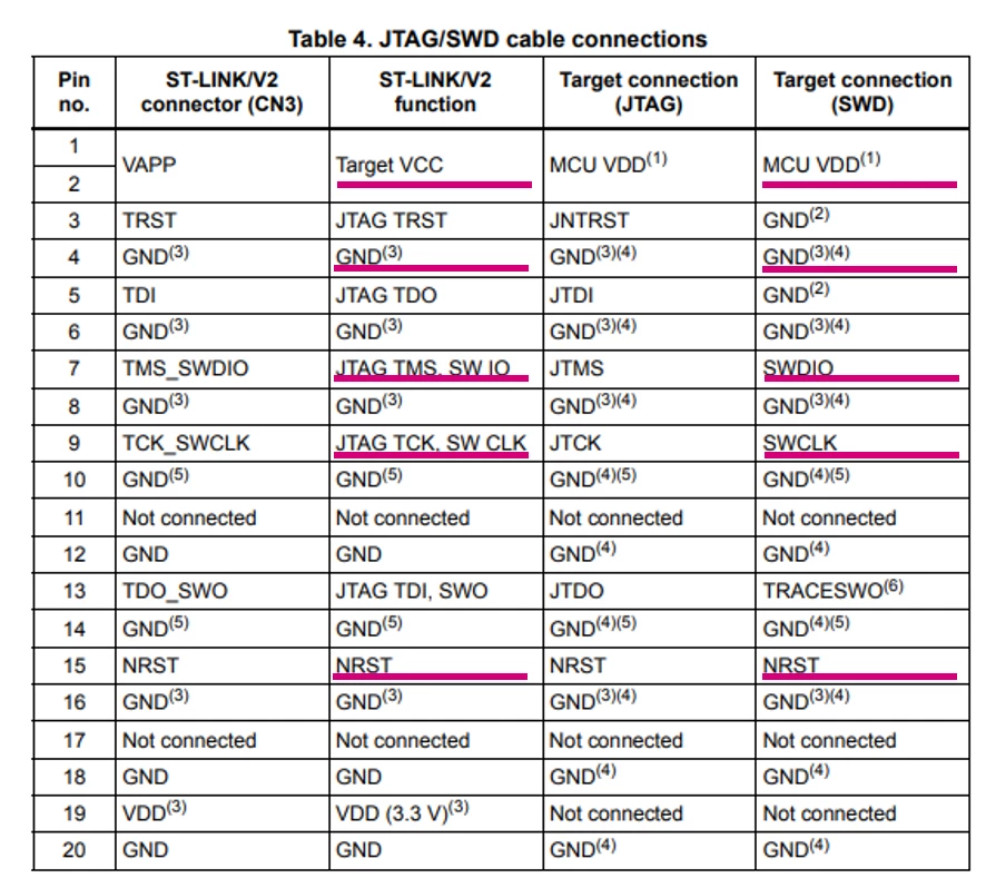

    Hi @Thilo​ , unfortunately the adapter is not yet available in the toolkit, It will be available soon (est. init Oct). If possible for you, I suggest to directly wire the ST LINK V2 pins to the STDC14 connector following the respective schematics as shown below. Regards

    As a workaround I used the 10-pin Cortex-M to 14-pin STDC cable from the STLINK-V3 and a separate JTAG 20-pin Adapter to connect to my STLINK/V2
